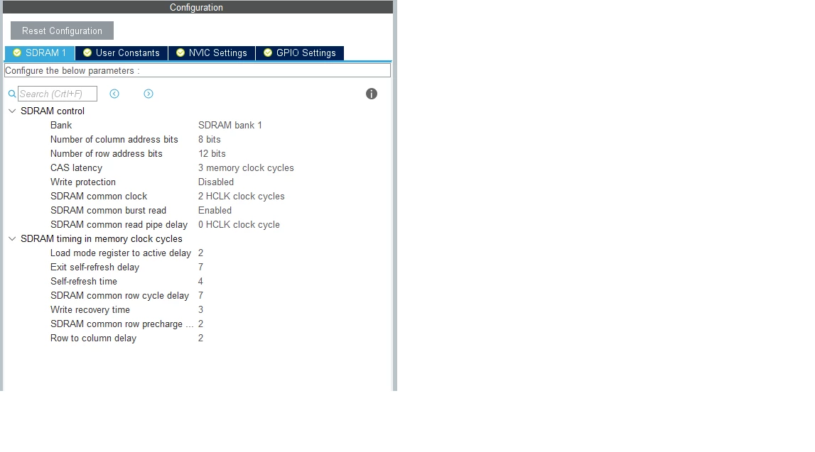

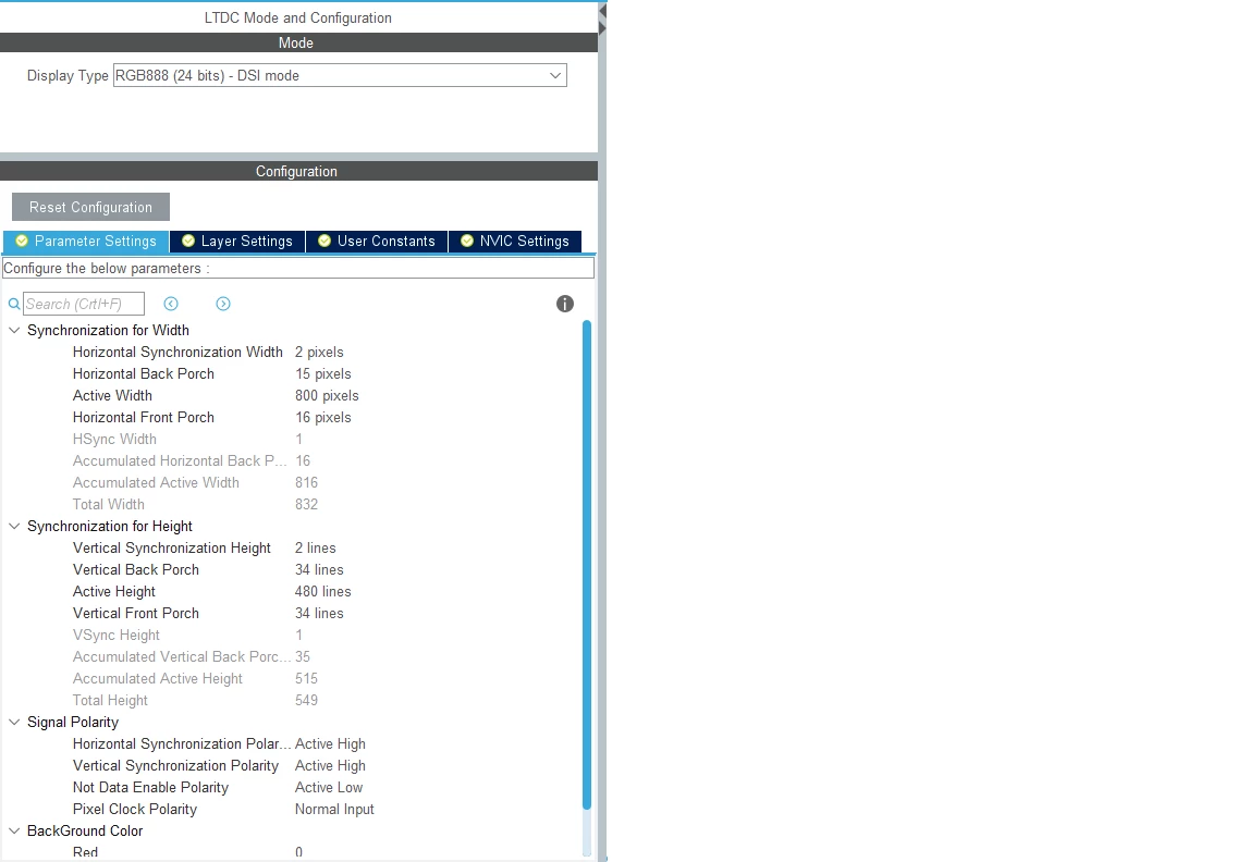

Hi everyone! I'm trying to create a project using CubeIDE 1.3, Touchgfx 4.13 and f769i-disco board. I have started building project with Cube and then added touchgfx using "additional software" menu. I have succesfully configured external SDRAM and display driver: I can see data being put into a buffer by touchgfx, but the screen shows nothing but a white stripe in the middle. I have tried copying parameters for ltdc and dsi from example but it still doesn't work.
So the question is: has anyone managed to configure the screen on this board properly without just copying BSP functions?

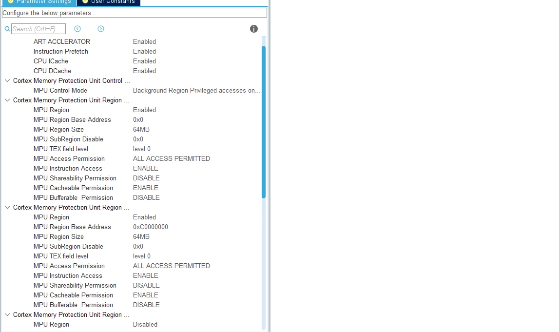

I've tried using TouchGFX template, but it doesn't seem to work either
The microcontroller falls into hard fault as soon as it reaches
osKernelStart();
even after I made stack and heap in project settings 10 times bigger

So i finally launched the application
Enabling MPU cacheable permission for external flash solved the problem
