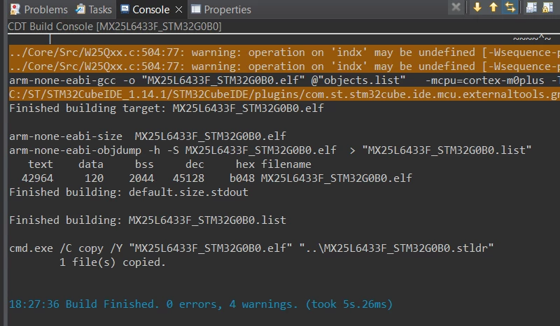

Hi everyone.
I am working on STM32G0B0 MCU and develop UI with touchGFX. I researched how to generate external loader for external NOR FLASH(MX25L6433F).
I use SPI2 on MCU(SMT32G0B0). And edited relevant files.
I applied all of steps on following links:
https://blog.embeddedexpert.io/?p=2189
Like W25Q FLASH Memory || Part 9 || External Loader in SPI Mode (youtube.com)
Like External loaders for SPI flash: a "standard" version (youtube.com)

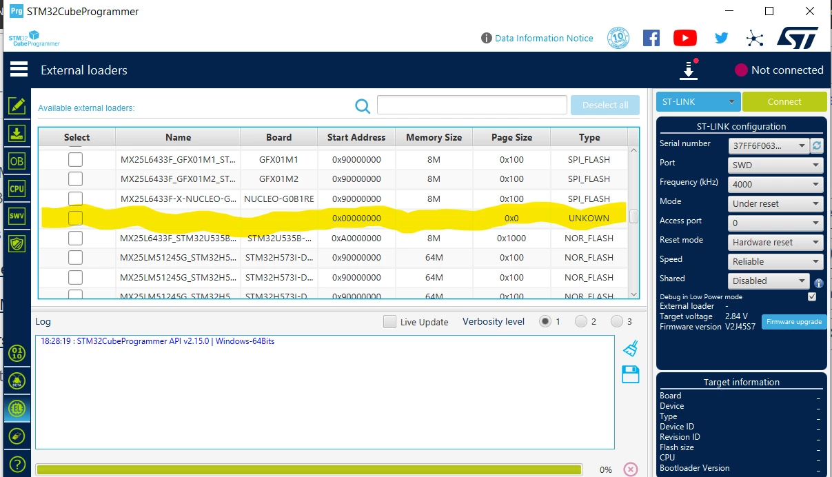

I separately tested it. But xxx.stldr file is not working. STM32CubeProgrammer is unknown my STLDR file.
I build without any problem. I checked that makefile under debug folder. There is an error that:
fail-specified-linker-script-missing:
	@echo 'Error: Cannot find the specified linker script. Check the linker settings in the build configuration.'
	@exit 2
warn-no-linker-script-specified:
	@echo 'Warning: No linker script specified. Check the linker settings in the build configuration.'
.PHONY: all clean dependents main-build fail-specified-linker-script-missing warn-no-linker-script-specified post-build
Could you help me about this problem. Is there more easy way to generate custom external loader?
Well I'm just using GCC+MAKE to build a small HAL based project.
This is a Linker Script for a G4, but should be viable for a G0
The empty fields in STM32 Cube Programmer is indicative that the StorageInfo structure has not been built/bound correctly.
You could look at the .MAP and perhaps inspect with objcopy or objdump

I ended up building and posting this
https://github.com/cturvey/stm32extldr/tree/main/g0_mx25l6433f
The code basis here should be able to support builds for Winbond W25 and Macronix MX25 parts from 16 Mbit to 2 Gbit, just need to recompile

Thank you so much @Tesla DeLorean.
