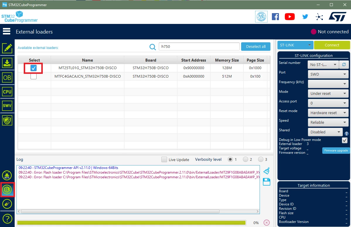

Ehsan
July 26, 2022
I encountered a similar issue. Trying the program STM32H750B-DK discovery board using STM32CubeProgrammer in Ubuntu. here is the log:
 08:47:43 : STM32CubeProgrammer API v2.11.0 | Linux-64Bits
 08:47:45 : ST-LINK SN : 0036004A3137511133333639
 08:47:45 : ST-LINK FW : V3J10M3
 08:47:45 : Board    : STM32H750B-DK
 08:47:45 : Voltage   : 3,28V
 08:47:45 : SWD freq  : 24000 KHz
 08:47:45 : Connect mode: Normal
 08:47:45 : Reset mode : Software reset
 08:47:45 : Device ID  : 0x450
 08:47:45 : Revision ID : Rev V
 08:47:45 : Debug in Low Power mode is not supported for this device.
 08:47:46 : UPLOADING OPTION BYTES DATA ...
 08:47:46 :  Bank     : 0x00
 08:47:46 :  Address    : 0x5200201c
 08:47:46 :  Size     : 308 Bytes
 08:47:46 : UPLOADING ...
 08:47:46 :  Size     : 1024 Bytes
 08:47:46 :  Address    : 0x8000000
 08:47:46 : Read progress:
 08:47:46 : Data read successfully
 08:47:46 : Time elapsed during the read operation is: 00:00:00.002
 08:47:53 : Memory Programming ...
 08:47:53 : Opening and parsing file: GPIO_IOToggle.hex
 08:47:53 :  File     : GPIO_IOToggle.hex
 08:47:53 :  Size     : 4,56 KB
 08:47:53 :  Address    : 0x90000000
 08:47:53 : Erasing memory corresponding to segment 0:

N. SANTINI
July 27, 2022
The method suggested in this thread only applies to "custom" external loaders, here you are using an ST development kit that has its dedicated external loader already included in STM32CubeProgrammer so it must be another issue.
Have you selected the proper one in the "EL" tab ?
0693W00000QMFPYQA5.pngBest regards,
Nicolas
Ehsan
July 27, 2022
Great, thanks!
I am new to this tool and did not choose external loader. It works now.
