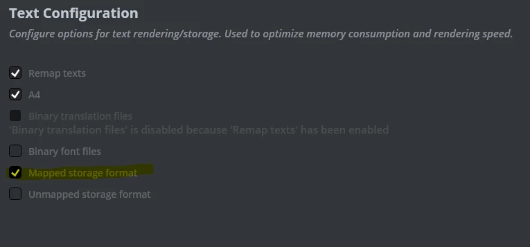

Hi all,
I'm trying to put some TouchGFX data (images, text, ...) in an external flash (S25FL128L) on a custom board with STM32H7B0VB mcu. I'm using the octo-spi peripheral as quad-spi.
So, I followed the guide to make an external loader and I did it. It seems to work properly: if I load the .stdlr file in the STM32CubeProgrammer I can read, write, erase sector and mass erase the external flash.
Also, if I try to debug (STM32CubeIDE) a project using the loader without putting elements into external flash all works well and I can see all the memory locations.
The ploblem occur whe I try to put somenthing inside the external flash. I do that in the linker script with TouchGFX sections: IntFlashSection and TextFlashSection. See the script below:

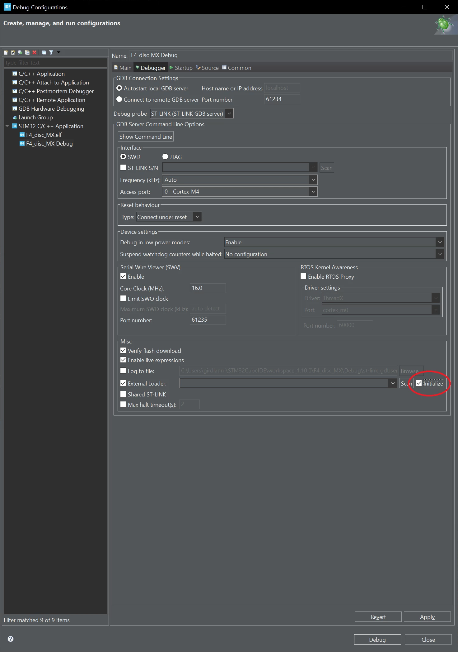

The output of the console when I try to Debug or Run with this linker script is:

>>I don't know how to solve this. Any ideas?
Get more verbose logs, use the Command Line variant of STM32 Cube Programmer.
Make sure it's loading the right External Loader, and from the directory you expect.
You can instrument External Loaders to use any GPIO or UART available on the board to debug and understand what's happening internally.
CubeIDE + GDB Server, whole other levels of opportunity to fail there, but without knowing the loader is bullet-proof, and having a lot more diagnostic output, it's going to be a challenge to get a lot of support.

Have you check in your application in TouchGFX Designer if you have this checkbox checked ?
/Osman
nikof
nikofAuthor
July 7, 2022
Yes, I'm in memory mapped mode.
Yes, it is checked.

This could be because you need to initialize the external loader in your debug configuration inside STM32CubeIDE.
Do you know if this checkbox is checked?
nikof
nikofAuthor
July 11, 2022
It was unchecked, but checking it doesn't resolve the problem.
