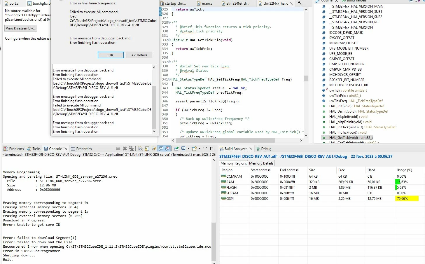

I am experimenting with a newly purchased STM32F469I-DISCO AU.
I immediately had issues in downloading to the external flash. Is not a configuration issue, in fact the error is random: 5% of the times I manage to correctly flash it, most of the times I get errors like "Error: Unable to get core ID".
No issues with the internal memory, but as soon as I allocated anything that requires to write more than one block of flash, the downloading problem happens. I confirm the flash gets written, since when it fails at 50% or so, I see the loaded picture shown half on the LCD.
Attached an example of a project I managed only twice to correcly flash, and only from the TouchGFX suite, not from the CubeIDE. Also, in both TouchGFX and CubeIDE, the error is the same, just the percentage changes:

As a work around I followed this ST post - nothing really changed.
Another example can be seen in the screenshot here:
There is a previous post I did, showing a project which I can fully share, trying to link correctly in the external flash a simple array, with small data like 16B, no problem. If I expand this array from 16B to the real 1.33MB, it fails most of the times. My board is the variant DK32F469I$AU1 - I attached the project so you can try.
I used the latest ST-Link firmware (March 2nd 2023), and both the flash loaders "0x434" from the 2.6 Programmer (replaced in the internal programmer of CubeIDE 1.11.2), but also with the original flash loader.
Programmer data (from the dev board) and the typical error is reported below. Fun fact: the BL version does not appears all the time - comapre with the previous report in this post.

Memory Programming ...
Opening and parsing file: ST-LINK_GDB_server_a02036.srec
 File : ST-LINK_GDB_server_a02036.srec
 Address : 0x08000000
Erasing internal memory sectors [0 4]
Erasing memory corresponding to segment 1:
Erasing external memory sectors [0 21]
Download in Progress:
Error: failed to download Segment[1]
Error: failed to download the File
Encountered Error when opening C:\ST\STM32CubeIDE_1.11.2\STM32CubeIDE\plugins\com.st.stm32cube.ide.mcu.externaltools.cubeprogrammer.win32_2.0.500.202209151145\tools\bin\STM32_Programmer_CLI.exe
Error in STM32CubeProgrammer
Shutting down...
Exit.

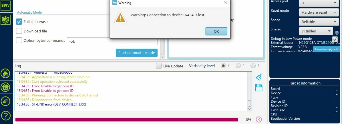

I add here a log of the ST-Link GDB Server - I think is providing some good infos.
Specifically, seems the STLink speaks a different language than the server. The ST-Link sned a vKill request, which is not understood. But also, why...
[15.763] spawnCubeProgrammer(): 13:21:13:213 Error: failed to download Segment[1]
[15.763] spawnCubeProgrammer(): 13:21:13:213 Error: failed to download the File
[15.763] spawnCubeProgrammer(): ------ Switching context -----
[15.767] WriteFlashDone(): Error in STM32CubeProgrammer
[15.767] write(): <756> Tx: $E05#aa
[15.782] read(): <756> Rx: $vKill;a410#33
[15.782] handlePacket(): Hidden/Unsupported v-command 'vKill', see RSP for details
 To finish, I tried with the CubeProgrammer, and the result is the same, it closes the connection
