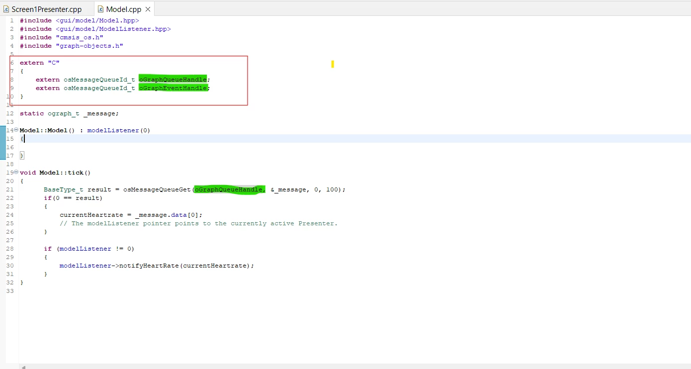

Save yourself from many complications handling the HAL abstractions from the TouchGFX layer, and use FreeRTOS queues and tasks to handle the data flow. (Personal opinion)
Functional example Model.cpp
