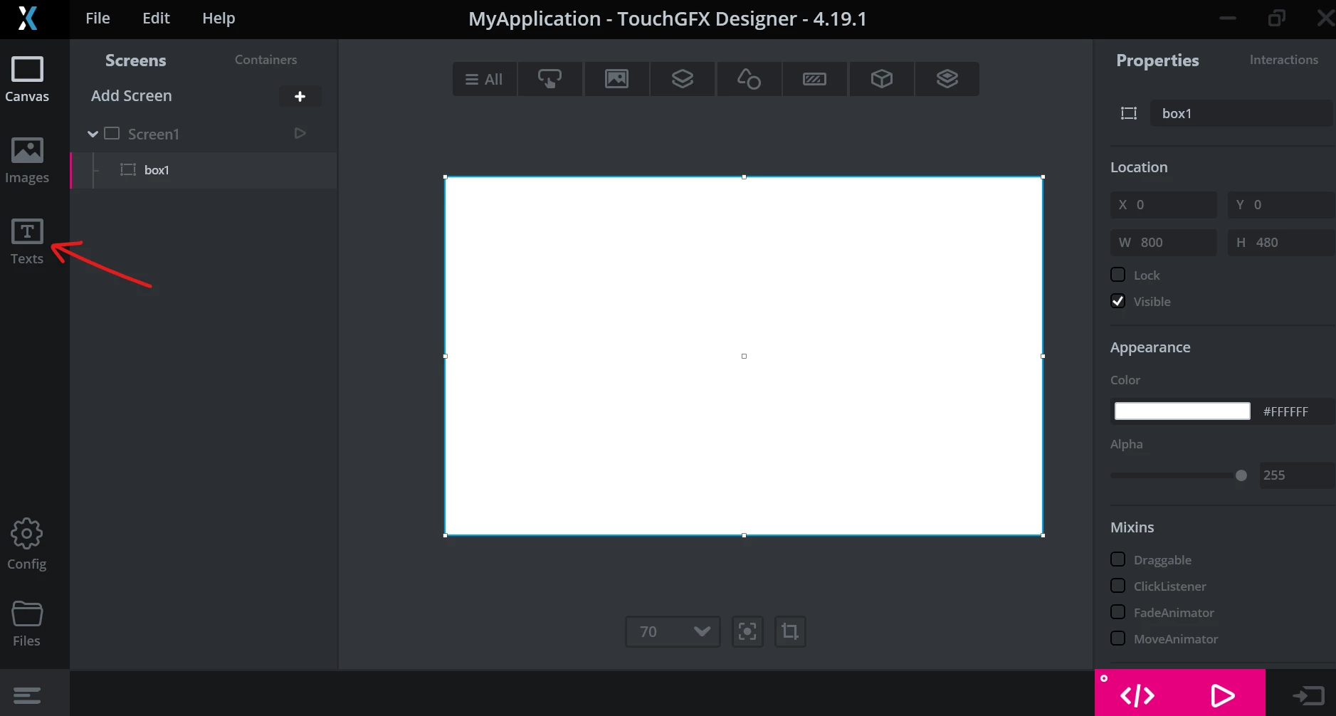

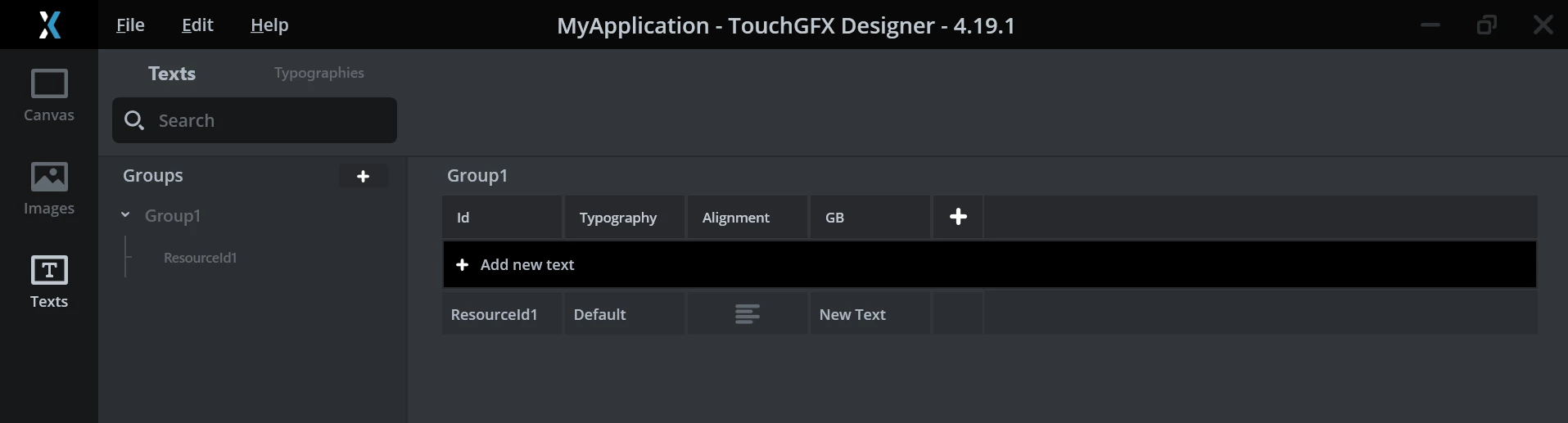

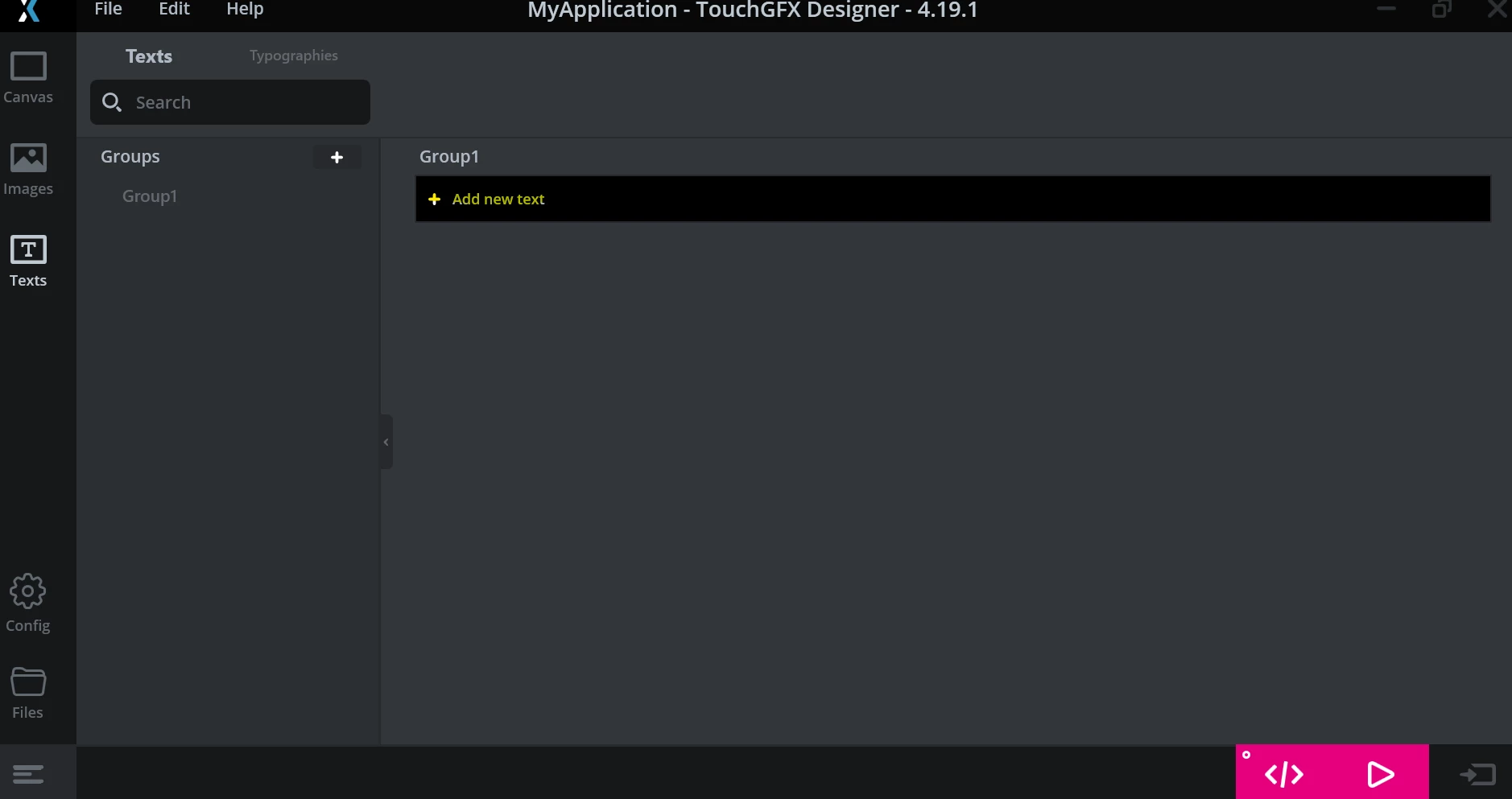

I'll show you the basics of how use resources under TouchGFX Designer :
1- Create you project and go "Text" on the left panel.

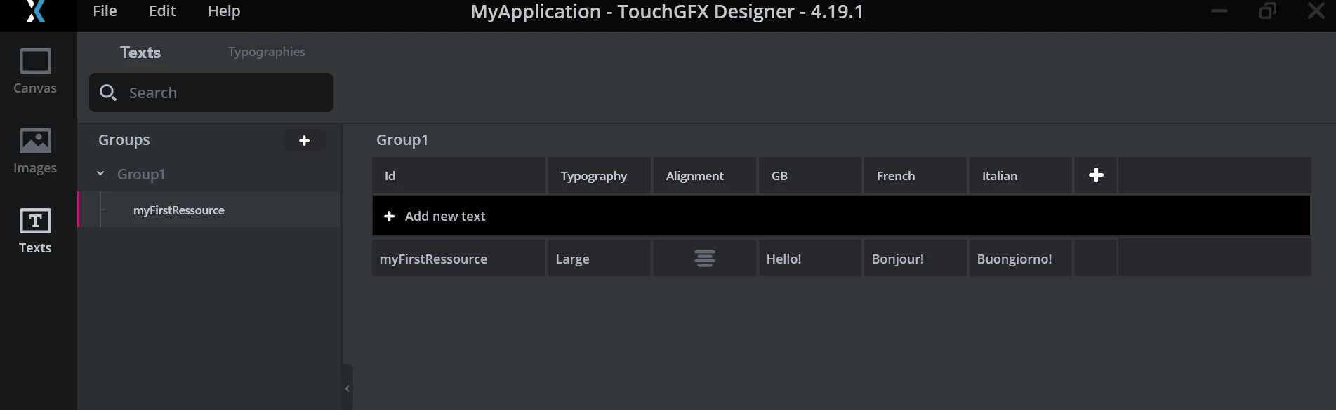

2- Click on "Add new text" and edit the resource you want. You can modify the 'id" of your resource, the "typography", the "alignment", and finally your text. "GB" is already here by default and it's your text in English language, you can add an other language by clicking on the "+" button.
0693W00000LyaFBQAZ.png0693W00000LyaFbQAJ.pngTry to edit it like this :

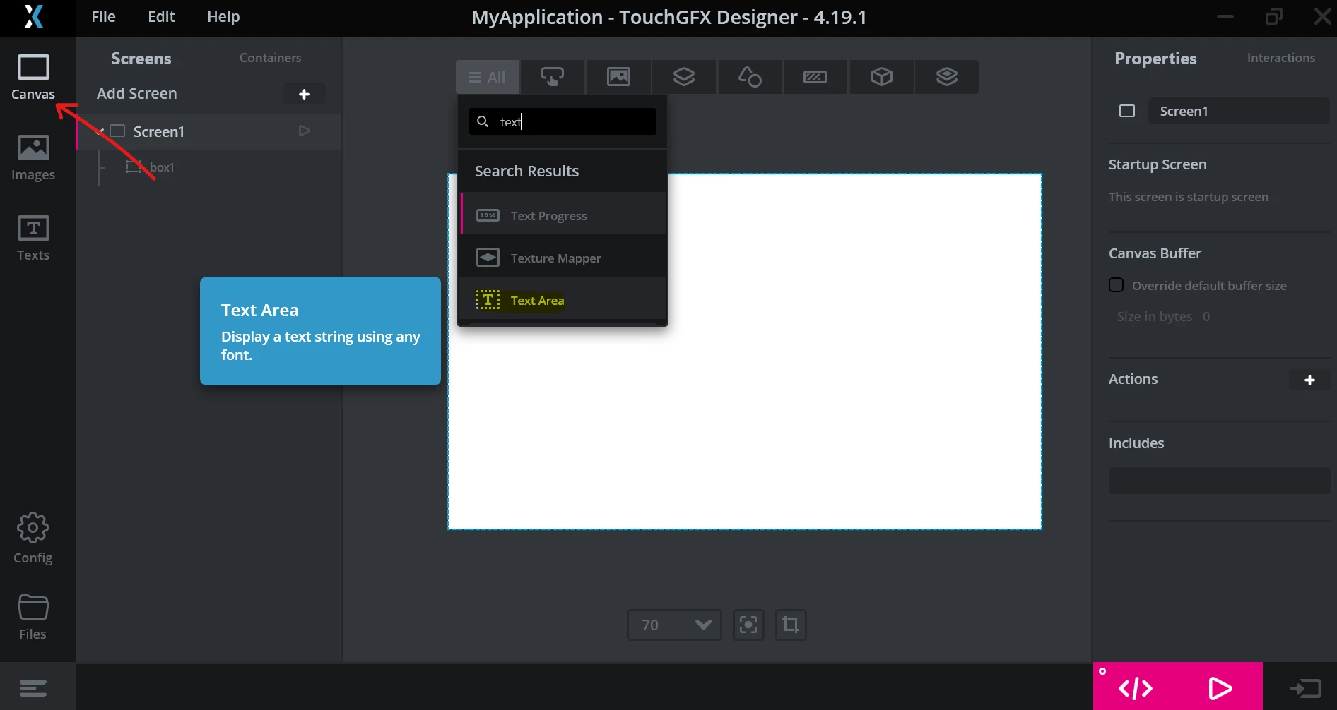

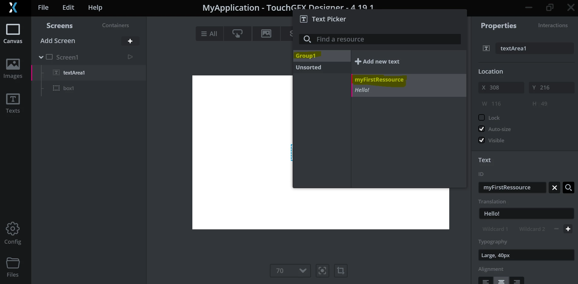

3- Go back to your canvas and add a new text widget

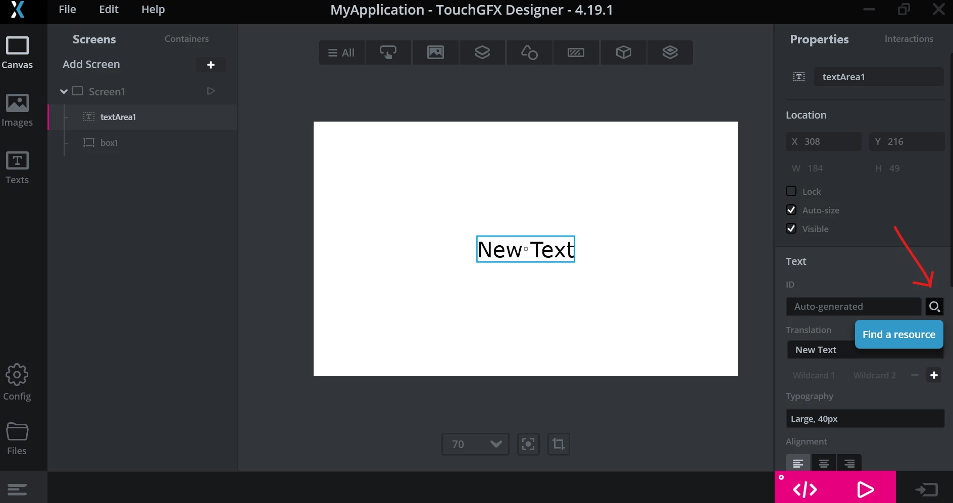

4- In right panel, click on the loupe under the "Text" section

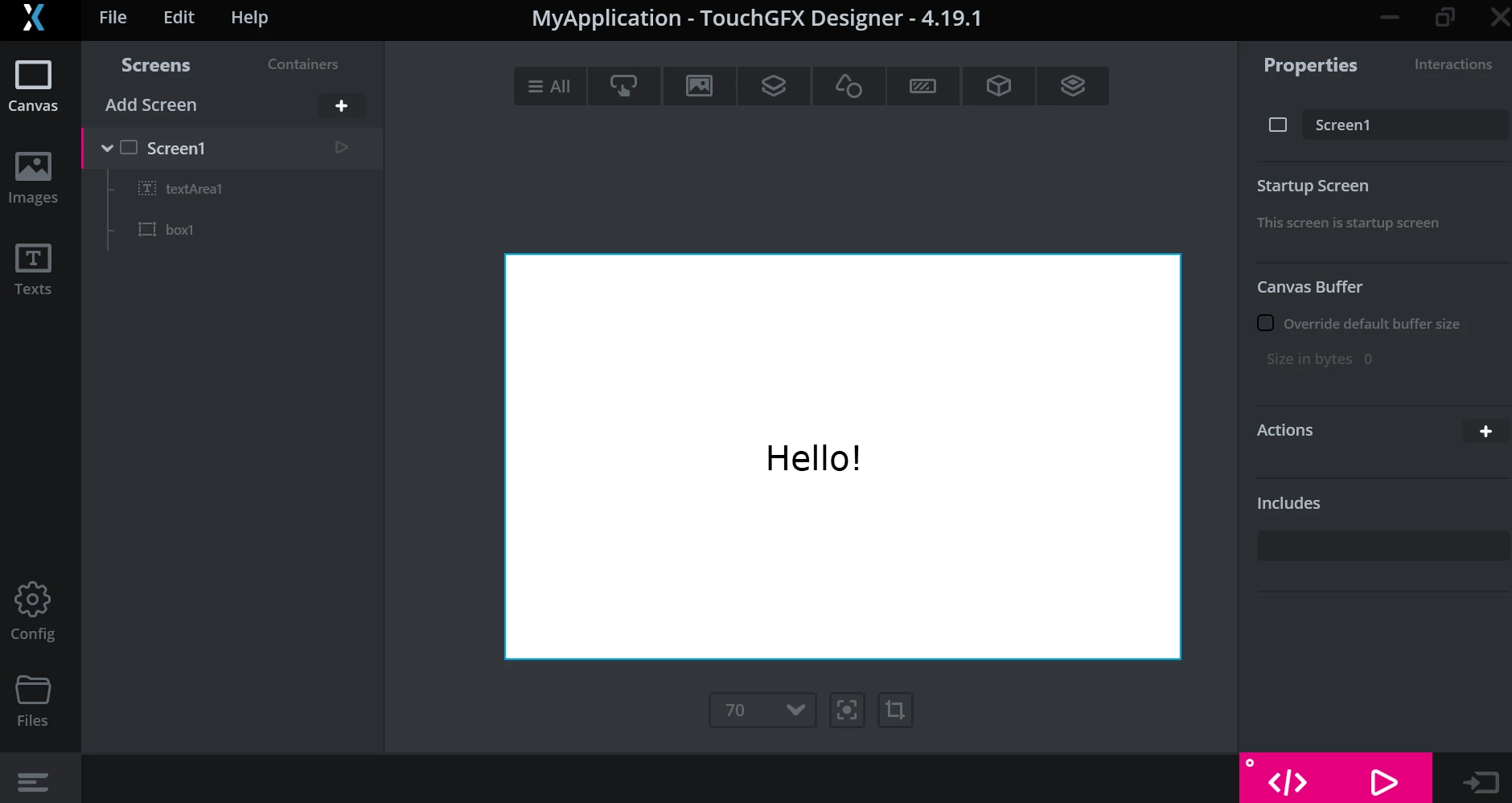

5- Click on "Group1" and click on the new resource we just created.
6- Enjoy :)

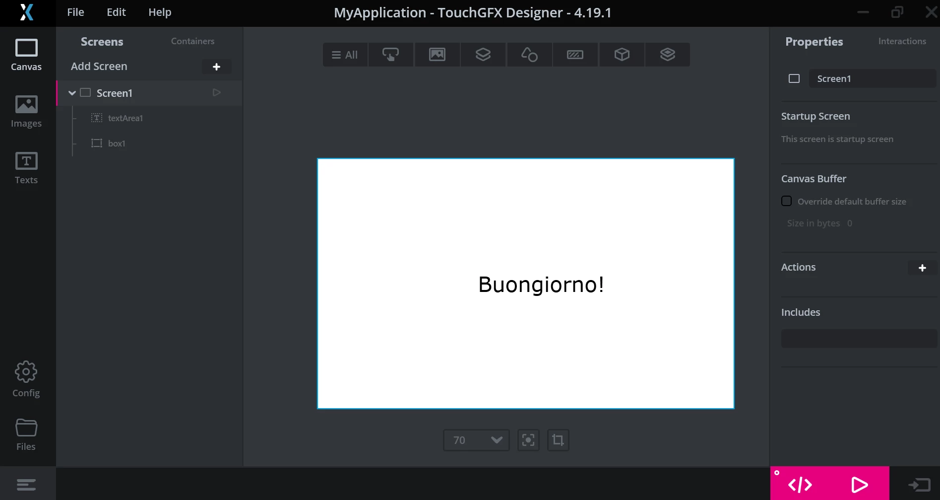

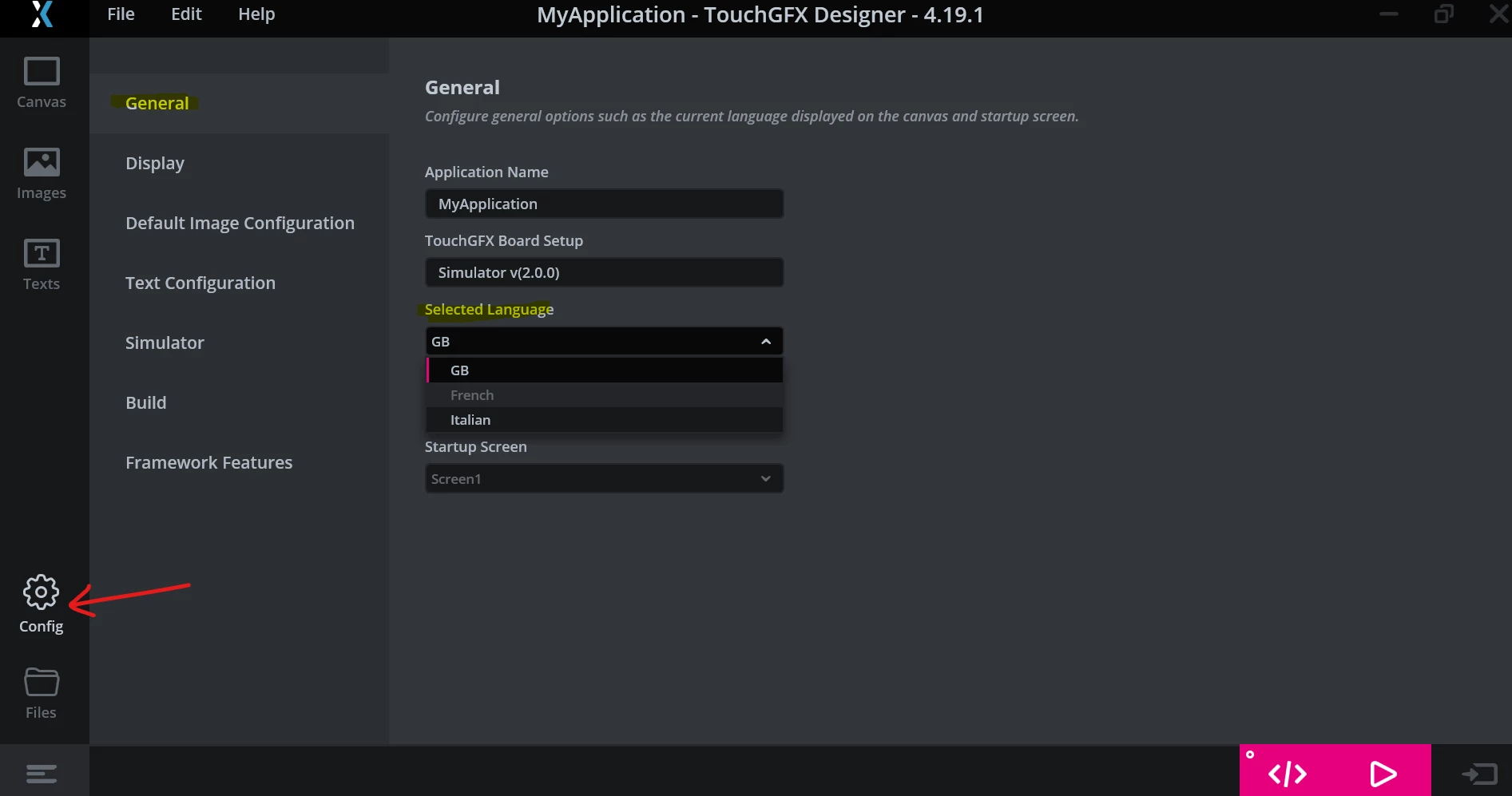

(7- If you want to change the language of your text, go to "Config" on the left panel, and under General, change the "Selected Language", then the change will automatically take place on you canvas)
