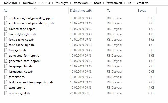

When I want to run a touchgfx example (of demo) in designer, compiler give me error like follows.
Run Simulator
 Generate
 Done
 Generate Assets
 make -f simulator/gcc/Makefile assets -j8
 cannot load such file -- lib/emitters/typed_text_database_hpp
 an error occurred in converting texts:
 Cleaning generated files from generated/texts and generated/fonts.
 make[1]: *** [texts] Error 1
 generated/simulator/gcc/Makefile:229: recipe for target 'texts' failed
 simulator/gcc/Makefile:32: recipe for target 'assets' failed
 make: *** [assets] Error 2
 Failed
 Failed
What can I do about that?

It looks like your installation is borked - "make assets" will generate a lot of files, text related ones included, which is what you're seeing here.
So you're pressing "Run simulator" from the designer?
Could you check if the following folder exists? Sounds like it doesn't.
\touchgfx\framework\tools\textconvert\lib\emitters
/Martin

Folder is exist but there is no "typed_text_database_hpp" in the folder like the said error. I add a screenshot of folder.

TouchGFX version 4.12.3. "TouchGFX Demo 1" and "ProgressIndicator Example" give this error. I didn't try other examples.
