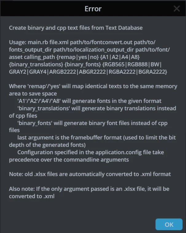

My TouchGFX project is originally created with v4.16.1. I just downloaded latest version of TouchGFX i.e. 4.18.1. The latest version tried to convert my project and threw below error. So, I opened the project with v4.17.1 and it converted fine. But when I try to open with 4.18.1, it throws error. Please let me know.

I finally got back to this time. I tired converting from 4.16.1 to 4.18.1 and this time it worked. The only difference from last time is that the 4.16.1 project grew more. More images and fonts were added. Anyway, I am glad it worked now. Thanks.

Romain DIELEMAN
January 25, 2022
Could you share your logfiles for TouchGFX 4.17 and 4.18.1? They can be found under %appdata%/Roaming/TouchGFX-<version number>.
Could you give more info on your project or share it ? I was not able to replicate it on my side with simple demos.

I don't find that path under my TouchGFX installation.
