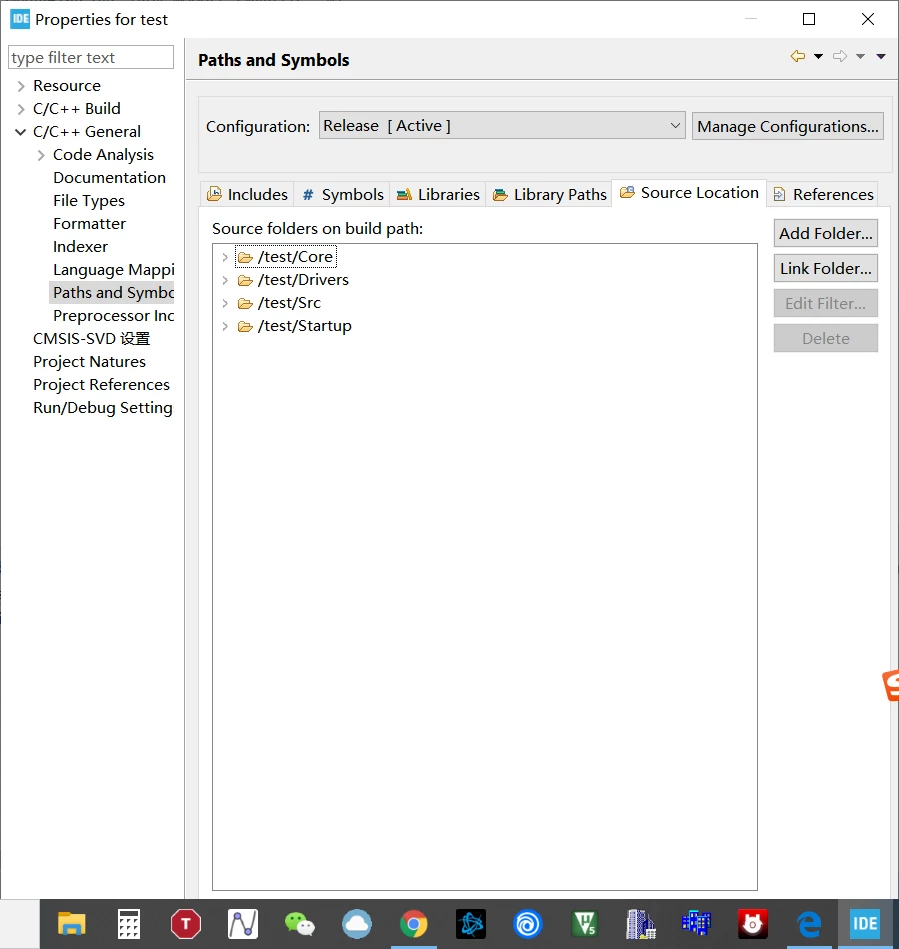

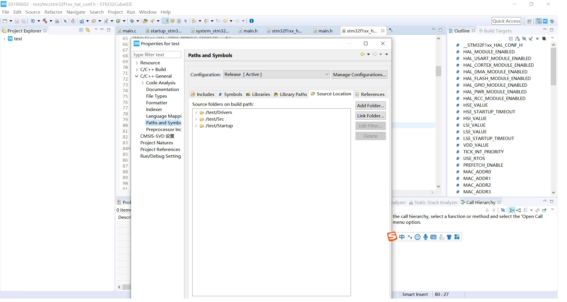

Hi, I met the same problem several days ago ,yesterday night I found the cause of this problem.
After “clean project�?, the directory of the project source file was missing, the file path under "/test/core " is missing.After manually adding the path "/test/core", the problem is solved. 0690X000008iOeYQAU.png  :face_with_tears_of_joy:I hope you can understand my poor english:face_with_tears_of_joy: 0690X000008iOedQAE.png
