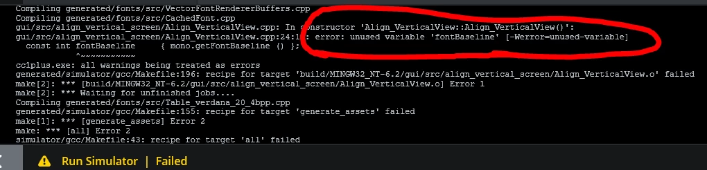

error: unused variable in GfxDesigner
Align_VerticalView.cpp:24:12: error: unused variable 'fontBaseline' [-Werror=unused-variable]
const int fontBaseline { mono.getFontBaseline () };

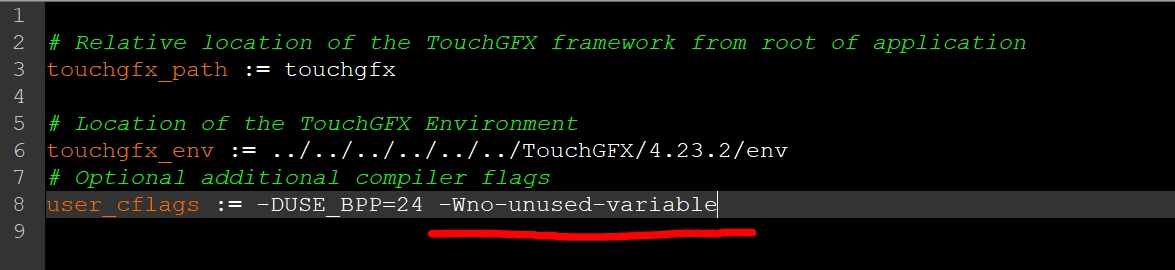

    Add ' -Wno-unused-variable' to \config\gcc\app.mk
