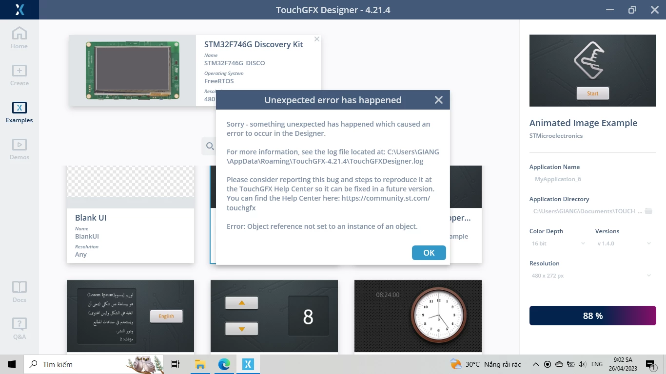

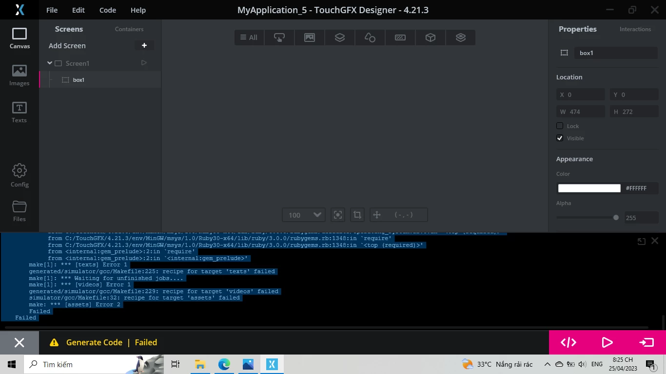

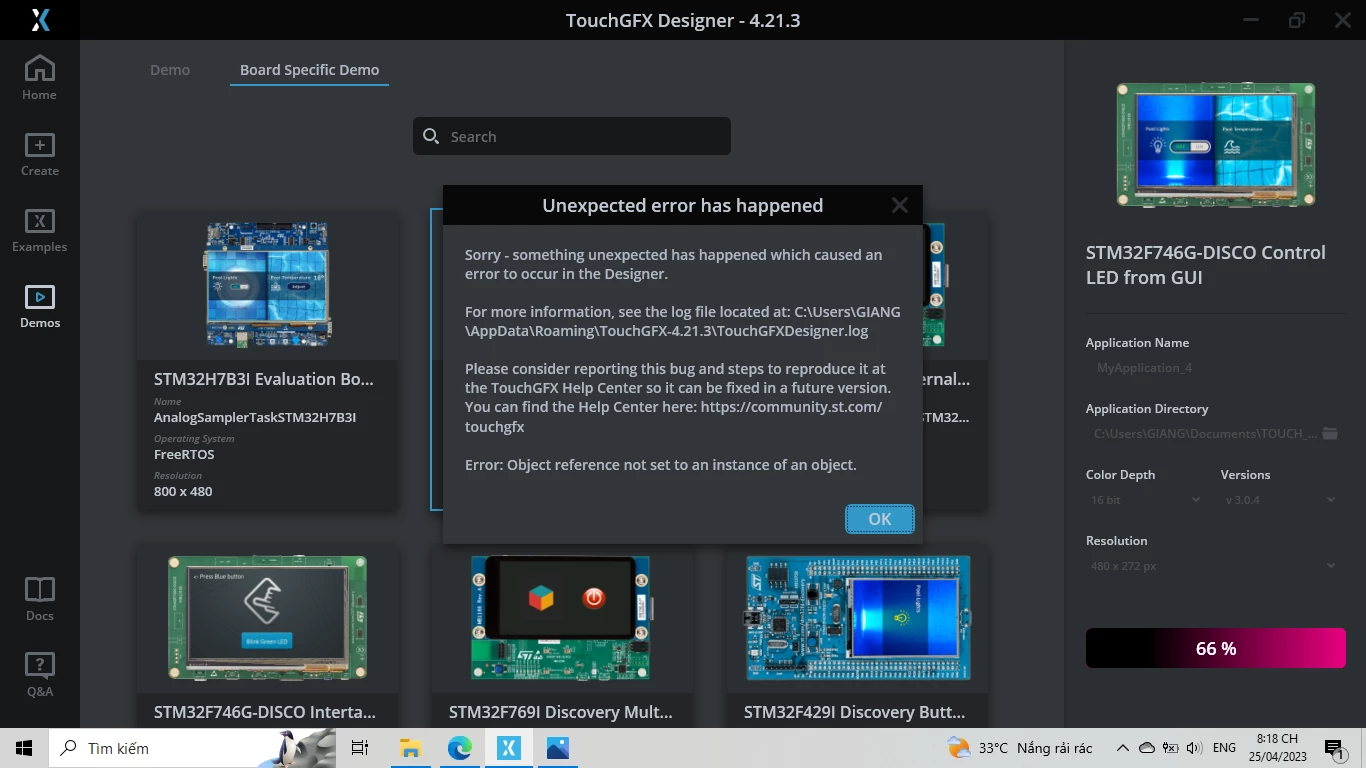

ERROR IN TOUCH GFX 4.21.4
i am having problem when i try to use demo or create a project, these errors keep repeating even when i restart the app i have uninstalled 4.21.3 and installed the latest version but it keeps crashing.
Did I skip any steps during code generation or initial setup?
​4.21.4
_legacyfs_online_stmicro_images_0693W00000bipKmQAI.png​
4.21.3
_legacyfs_online_stmicro_images_0693W00000bimzmQAA.png.

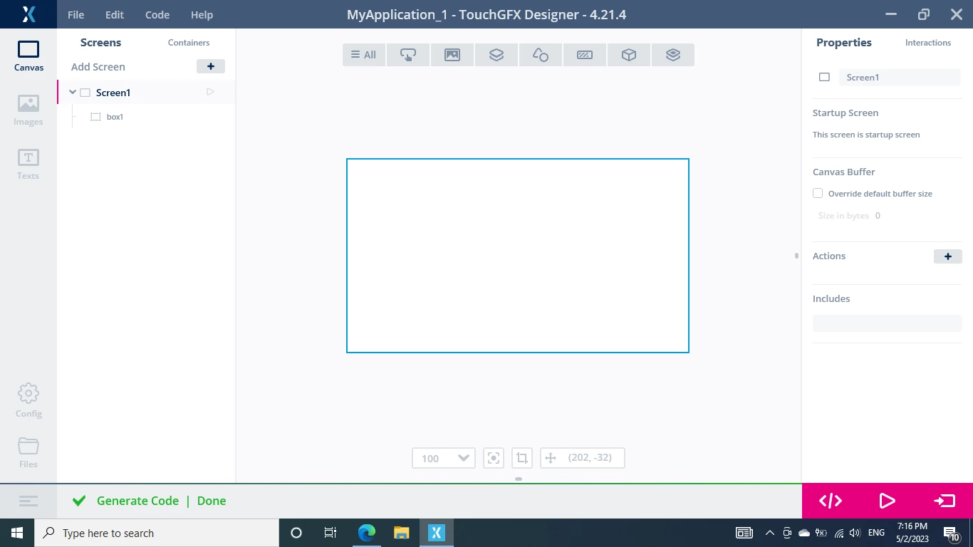

OWLchan
OWLchanBest answer
May 2, 2023 12:32 PM UTC
ok touchgfx worked, after the 2nd reinstall of windows, maybe it's not very friendly with local languages, hopefully in the future i can use it in vietnamese, my approach seems a bit waste time. hope others have a better way of doing it.
this is how i made touch work properly
-reinstall windows with default language and default keyboard(united kingdom), don't edit anything.
- the initial microsoft account login seems to affect it too. (or because i have a vietnamese account).
in the end i want someone with a better solution than me, reinstalling windows is quite time consuming...
Thanks everyone for the support.  

Osman SOYKURT
Apr 26, 2023 2:38 PM UTC
Hello OWLchan,
Could you send us your log when you reproduce the issue? The file is located at : C:\Users\YOUR_USE_NAME\AppData\Roaming\TouchGFX-4.21.4\TouchGFXDesigner
/Osman

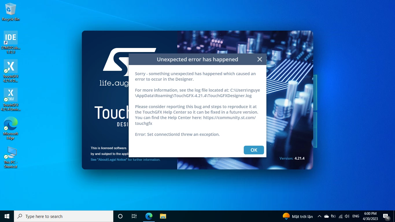

Osman SOYKURT
Apr 27, 2023 9:42 AM UTC
Hello OWLchan,
There's apparently an issue with your environment. Does your Windows is in Vietnamese? I can see that the Windows-1258 code format has been tried to be used but the ruby code converter doesn't support it (Encoding::ConverterNotFoundError in the logs).
My best guess would be to try to switch to an English-based Windows machine and see if the issue is still there.
/Osman

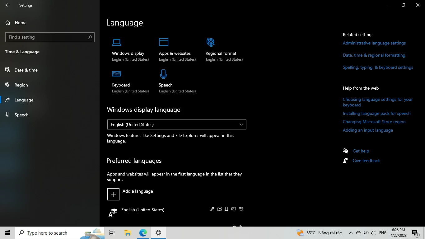

OWLchan
OWLchanAuthor
Apr 27, 2023 11:35 AM UTC
yes i use local language on my pc, and i have also seen some people have problem with the previous language ( turkish ) So i tried changing the language yesterday and installed reset the app, it still doesn't work. maybe I'll try reinstalling my own version of windows. I will be back soon.   
_legacyfs_online_stmicro_images_0693W00000bixaTQAQ.png​
OWLchan
OWLchanAuthor
Apr 30, 2023 11:10 AM UTC
ok i reinstalled my windows version in english it also disappeared the original error or rather i cant use touch gfx this is starting to take time already.

OWLchan
OWLchanAuthor
May 2, 2023 12:35 PM UTC
I reinstalled windows too, and it worked.
thanks :3333

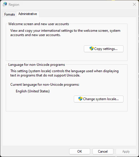

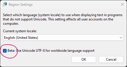

NSeba
Jun 20, 2023 3:35 PM UTC
Update: Mine started working after I made UTF-8 system wide.
I don't know what trouble it is going to make with other applications
OWLchan
OWLchanAuthor
Jul 29, 2023 6:30 AM UTC
do you mean it can work without restarting windows?
Can you tell me more about that?
