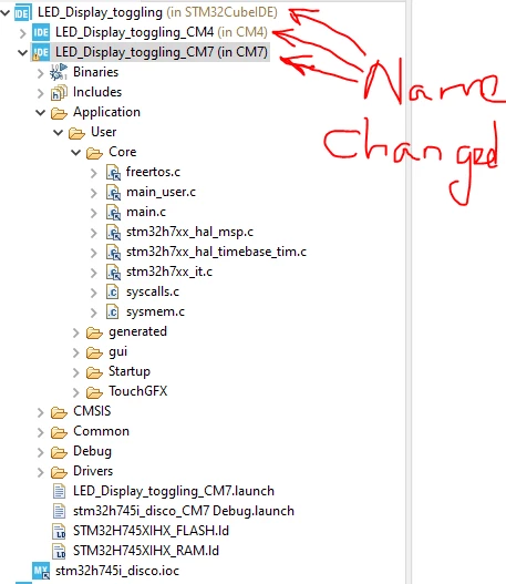

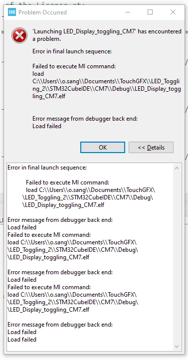

Error in final launch sequence: STM32H745I Disco board
So I have created a project on TouchGFX and opened it in CubeIDE but the name of the project was stm32h745i_disco even though I wanted it to be different. So I changed the name of the project in CubeIDE and now I cannot run nor debug my code. I get the error in final launch sequence. Couldn't find a solution to my problem in other posts.
I have uploaded the log file from the debugger for reference, which I myself honestly don't understand what it says.
I have 3 questions arising from this problem:
  1. How to solve the error in final launch sequence? Because this is not the first time I am getting this error.
  2. How to properly rename a project name in CubeIDE without causing such issues? I right click the project name and I clicked rename, but that seems to be non-ideal.
  3. The .ioc file cannot be opened anymore as it is still stuck on the original name, how to fix that?

In regards to question 2 and 3, I found the solution to that.
Solution to 2: https://community.st.com/s/idea/0873W000000PAykQAG/detail
Solution to 3: Rename the .ioc file to the new project name and you will be able to open it.
But question 1 still remains an issue, I still cannot run or debug!!! Error in final launch sequence!!! Someone please help!
