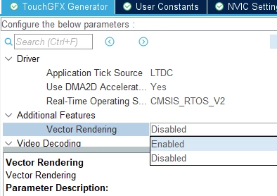

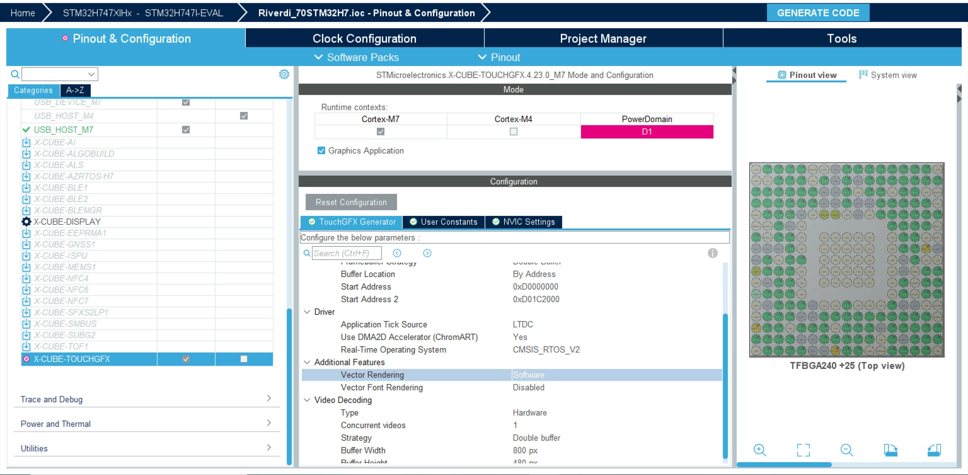

    Hello @gslm ,
    Unfortunately, I can see that there is a problem. We will fix this issue as soon as possible, but as a temporary solution for you to start working, open the STM32CubeMX project (Riverdi_70STM32H7.ioc file), go to Middleware and Software Packs -> X-CUBE-TOUCHGFX, under the TouchGFX Generator tab, change the Vector Rendering to Software. Then, press the Generate Code button on top right of the screen. Now, you should be able to compile with no errors.
    CubeMX settingsCubeMX settings
    Again, sorry for the inconvenience.
    I hope this helps you.
    Mohammad MORADIST Software Developer | TouchGFX

    gslm
    gslmAuthor
    Dec 28, 2023 10:44 PM UTC
    Thanks for the quick reply @Mohammad MORADI ESFAHANIASL!
    I downgraded TouchGFX Designer to 4.22 and could only change the Vector Rendering to "Disabled" for this test as oposed to "Software", but nevertheless this did result in a succesful compilation & board flashing. I believe there was a mismatch between the TouchGFX Designer and STM32CubeIDE versions of X-CUBE-TOUCHGFX.
