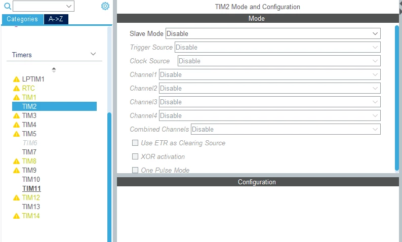

Enabling TouchGfx in CubeMx (built in CubeIDE) disables Timer2 - STM32F746-DISCO configuration - is this a bug?
0690X00000ARJX0QAP.pngWhen I enable TouchGfx in Middleware->Graphics the Timer2 is being disabled (in ParameterSettings->TimerInstrumentation I select Timer14). Is there a connection between those two or it is a kind of bug I can fix manually in code?

Khouloud ZEMMELI
Sep 18, 2019 3:37 PM UTC
​Hello @kajoje123​ ,
Which CubeMX version did you use ?  Did you mean that you created  MX project from CubeIDE ?
could you please share your ioc file ?
Thanks,
Khouloud
kajoje123
kajoje123Author
Sep 18, 2019 6:26 PM UTC
Yes, I meant the MX project form CubeIDE
STM32CubeIDE - Version: 1.0.2 Build: 3566_20190716-0927 (UTC)
STM32CubeMX - Version: 5.3.0.201907110903
I created new STM32 Project - all the peripherals were initialized as default (STM32F746NG DISCO). Timer2 is being disabled when I enable the TouchGfx
Khouloud ZEMMELI
Khouloud ZEMMELIBest answer
Sep 19, 2019 2:28 PM UTC
​HI @kajoje123​ ,
Thanks for ypur feedback, this bug has been already fixed and it will be available for  the next release -5.4.0-
Best Regards,
Khouloud
