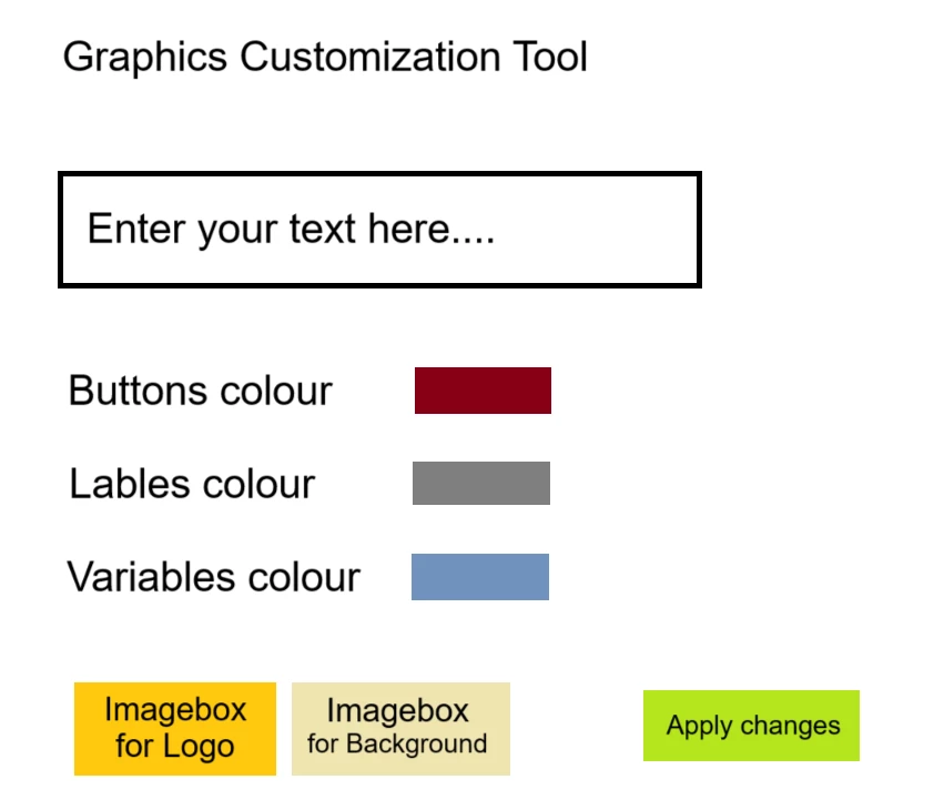

In short: I mentioned in the previous post that I want to design a new independet project based on TouchGFX lets call it (Toolchain or Graphical Custom Tool....etc) and this also based on the first application. So whatever i would change in the toolchain and then write its .bin file to the MCU then this change should somehow be applied to the first project and means here the texts or the colours whatever.
The first application already implemented and released but i would explain my idea below:
Now i would divide this topic into three parts 1. Images (which i already implemented) 2. Texts and 3. Colours.
1- Lets start with the texts part.. So we have too many text objects in the main project, but the customer only needs to change one text object using the tool. The problem is that we are using 4 different languages so i have two challenge:

2- Colours: the challange is how to (select all) the texts and change the colour of them?
I have an idea which is to sort the texts into 3 groups as shown in the picture of the tool... because the only way to change the text colour is to change the colour of the text object itself and its not possible to change the colour of the whole resource or anything else thatswhy i think on creating a 3 arrays and each array represent a group of texts.
