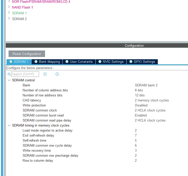

thanks’ for your reply. Today I've tested a bit more. I've tested with different locations in my external SDRAM. In my actual setup 0xD0000000 and 0xD0C00000 are used by LTDC and TouchGFX for the display. What we want to do is to show images from a camera on the display. The idea was to write the image data with DCMI to the external SDRAM area 0xD0800000 and use the dynamic Bitmap to show it on screen.
As soon as I generate the dynamic Bitmap Cache in the external SDRAM in address range 0xD0... the function dynamicBitmapGetAddress will point to the wrong address with 0xf0...Thus the setBitmap function will fail.
My next idea was to change the FMC bank mapping that SDRAM Bank2 is remapped to FMC bank2, but it will also fail to work on 0x70.. memory ranges of FMC bank2.
The actual work around is to use internal RAM at position 0x30000000.
 The FMC settings are as followed:
