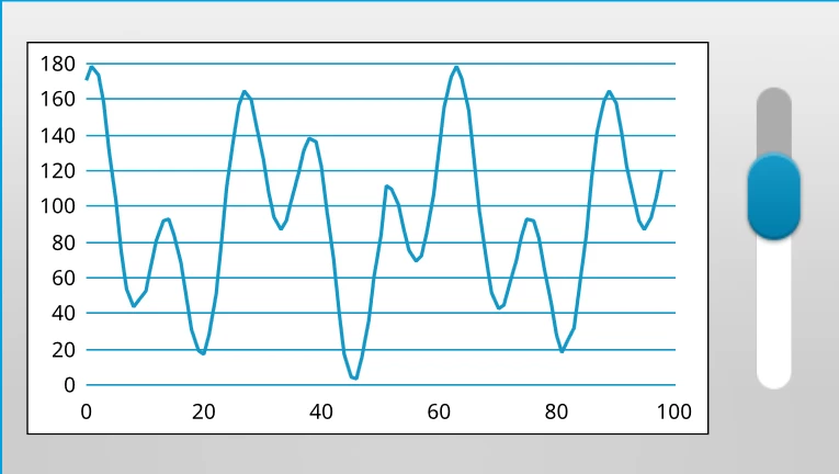

Thank you for the answer. unfortunately, I have 4.20.0. So I can't see that example. And the only example I can find is this one (for Simulator). Is it the same?

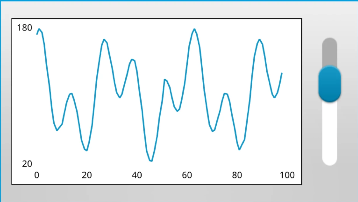

0693W00000Y7rbPQAR.pngThey adjust labels there but the problem is, I need to have only 2 labels: min and max. I need something like this:
0693W00000Y7rlFQAR.pngBut it feels impossible to do if my min is not 0.

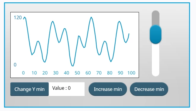

Hello again,
I modified this project to get closer to what you wanna do.
I think it cans provide you a nice first approach.
To explain quickly what I did :
  • Replaced the Y axis max and min labels by TextAreas with wildcards, to be able to display what I want in it and modify it dynamically.
  • Added a TextArea for the min value you wanna set (could also be done for the max) and 2 other buttons that allow you to increase and decrease the value on each click.
  • Added a button that enables you to update this value on the graph.
For the code, I invite you to take a look at Screen1View.cpp, everything is in there.
This was done quickly and could be improved a lot, but I invite you to test it and to play with it. What you want to achieve is definitely doable.
Let me know if you have other questions.
/Yoann
