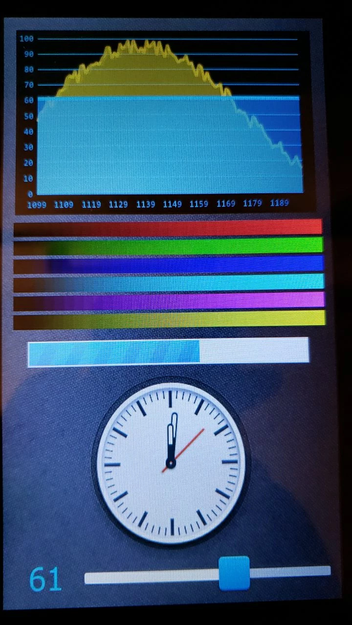

Current (4.16 and 4.17) DynamicGraph ​already can do it. Simply add as many lines as you need.0693W00000DpmyDQAR.jpg

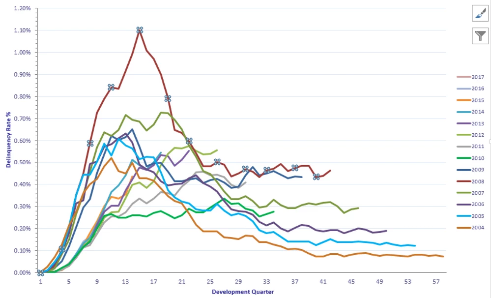

I am using 4.17, when I add a value it will only plot that singular value. I need different Y values on the same X point with different line styles. For example like this:

Exactly. Add extra lines in designer. Name them like graph2, graph3 and so on and then in your code call:
graph.AddPoint( y );
graph2.AddPoint( y2 );
graph3.AddPoint( y3 );
and so on...
My example has 2 graph: yellow is sinewave with some random noise and blue is slider value.​
