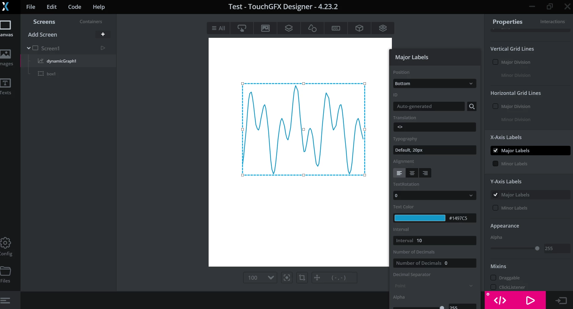

Hello, I just upgraded my TouchGFX to 4.23.2. When I created a new dynamic graph, I can't show the X-axis label and Y-Axis label.
May I know if I miss some settings? Thanks.

Hi
You must increase 'graph area margin' - 'bottom' and 'left' parameters, then labels comes visible. At default values are not visible because margins are zero.
Br JTP
