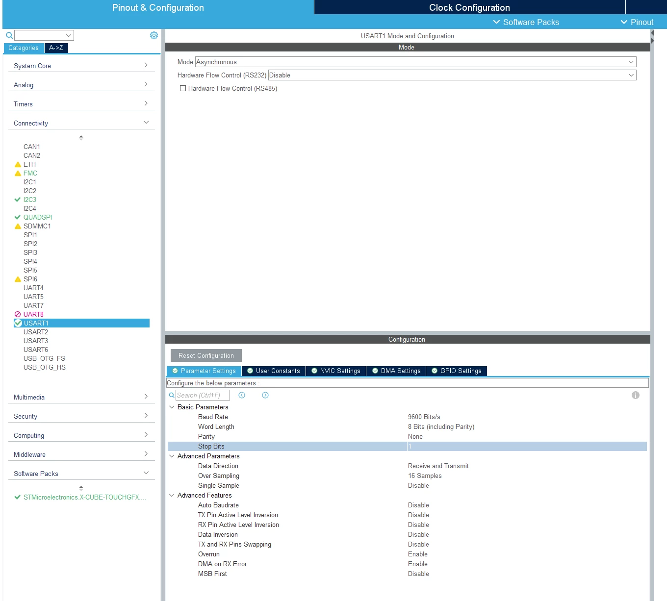

I did a simple example for you on the STM32F746G-DISCO board, I will join it to this post.
To explain quickly what I did for making it work :
  • Identify which USART port you are using (can be found in the schematic file of your MCU) and provide the following parameters in CubeMX. You can choose also another Baud Rate of course. When everything is set, generate code in CubeMX.

Now, if you wanna try it out, you can use a tool like Putty for simulating the UART value transmission part :
  • In the device manager, check the virtual serial port associated to your board (COM7 for me).
  • In Putty, select the right COM Port and select the Baud Rate you previously chose in CubeMX.
  • Start connection and send characters into the terminal by using your keyboard.
This project could be improved, for example by using interrupts instead, but I think that might be a good start for you.
Hope that it helped,
/Yoann
