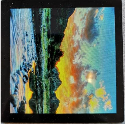

I used the following article to have a dynamic bitmap on the screen:
https://touchgfx.zendesk.com/hc/en-us/articles/207460605-Dynamic-Bitmaps-Load-images-at-runtime

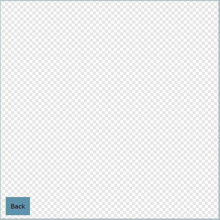

Then I draw a screen in touchgfx designer (attached designer.jpeg) where I would add a background image using dynamic bitmap.
What I actually get is in display.jpeg file (there's some aliasing but the display looks nice), if I press the area where the button are drawn it works, but the button is not visible.
How can I set dynamic bitmaps in background?
Thank you in advance,
Daniele

You can't add a dynamic bitmap directly from the designer, but you can add an image placeholder as the background image, add your button, and then later set the bitmap ID for the bitmap to be your dynamic bitmap id. When you invalidate that image it will read the image pixel data from your bitmap cache instead of somewhere in e.g. QSPI.
Does that make sense?
Another way is to reorder the way drawables are added to the view root container:
remove(button);
add(dynamicBmp);
add(button);
/Martin

You must add your dynamic bitmap as the bottom element (The first child of the views root container). The Button must be on top to be visible.
/Martin
remove(button);
add(dynamicBmp);
add(button);
/Martin
