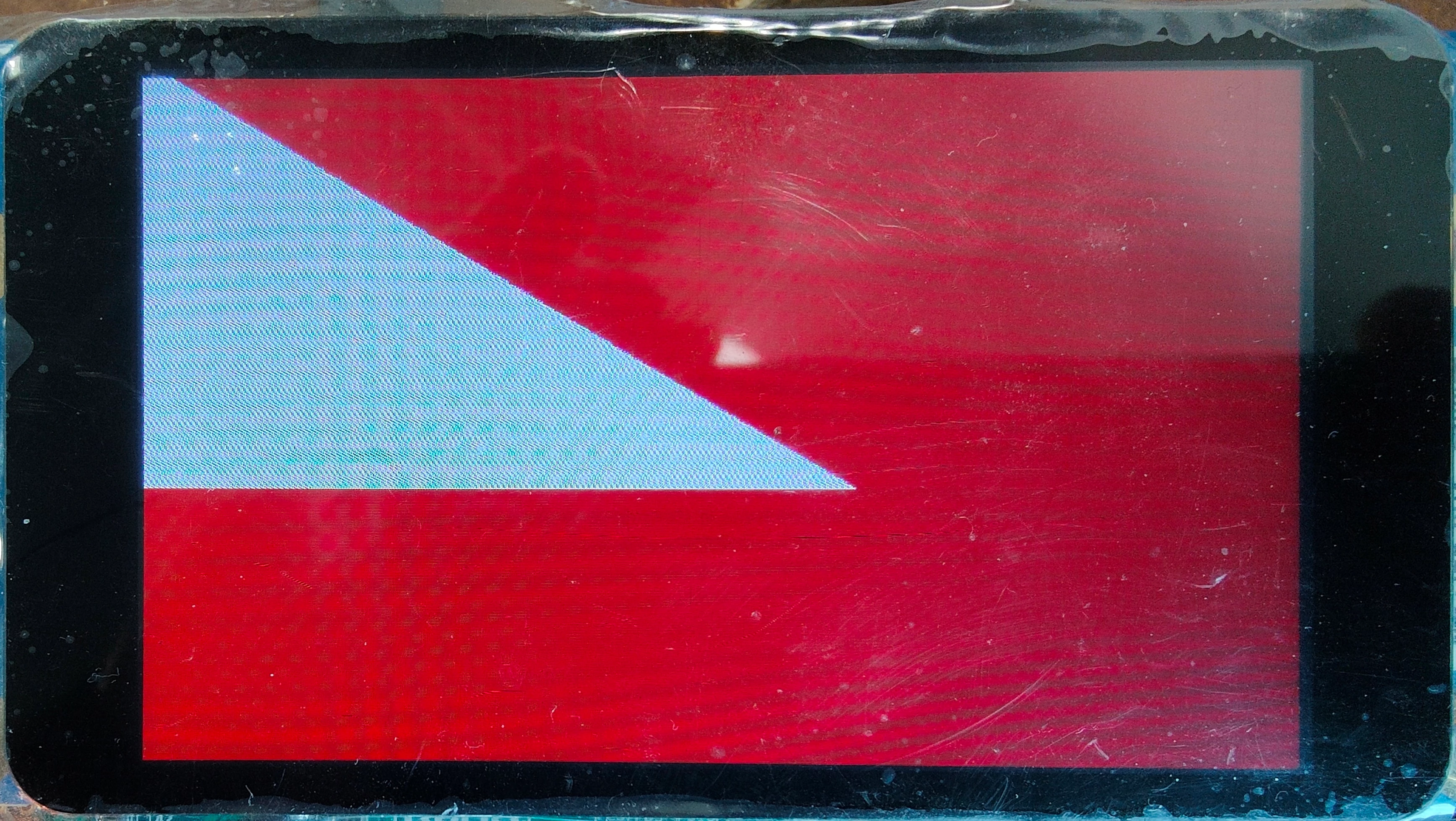

My project is based on touchgfx using DSI video mode with double buffer. When set the background, part triangle area cannot be refresh. The DSI video configured as the example project of "LCD_DSI_VideoMode_DoubleBuffering".

added description, background is RED(128,0,0), white triangle area is not refreshed.

Try adding the following lines after display re-initialization:
  LCD_force_refresh();
  LCD_ReqTear();
Hope this solved your issue.
