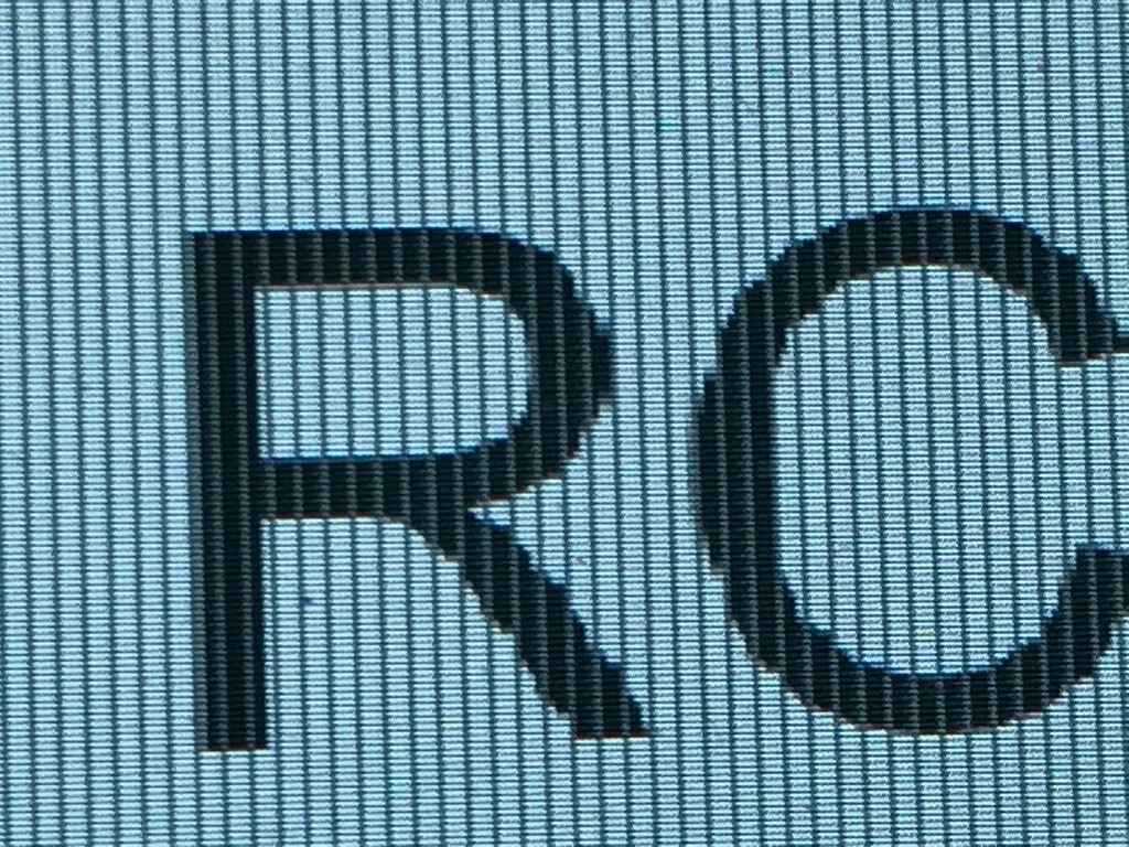

Display works, but not always is synced. Sometimes is horizontaly shifted.
How is regular way to sync start DSI video burst mode?
My display sync ok, but sometimes sync with this skip lines:

@Imen DAHMEN​ i add image with trouble on 480x1280 DSI sometimes display work ok , sometimes as on image. Skipped is every 4 line.

I solve horizontal shifted image with second call this in main after around half second from dsi init
 if (HAL_DSI_ConfigVideoMode(&hdsi, &VidCfg) != HAL_OK)
 Error_Handler();
and image trouble with skipped lines i correct with other porch numbers, but this all i solve within debug build with optimize 0.
After switch to release build with higher optimize levels in C lang skipped lines is randomly back.
How to init DSI ???
