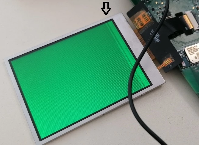

Hi st community members,
I'm having some stranges behaviors with the DSI and LTDC, I use these peripherals to communicate with my screen driver.
The driver need an init to give specific values for some registers, this step is well done.
After that i'm able to write pixel data thanks to the buffer area dedicated to the LTDC peripheral and with the command HAL_DSI_Refresh(&hdsi);.
My problem is that I need to write two times at least in the buffer area before the refresh to write correctly all the pixels data.
For exemple on the picture below, I write a full green screen (2 times needed with 0x00FF00) and after that I restart my program with only 1 write but with less green (0x00AA00). As you can see on the picture I have a partial write, at the right it remain the previous value (0x00FF00).

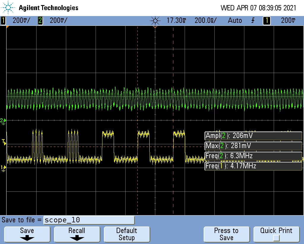

And when i take an oscillo I'm able to see that the sended data is not always 0x00AA00, I have the previous value 0x00FF00 instead. So after that I have verified the data in the LTDC buffer area, but all seems right (I have always 0x00AA00 in the buffer).
A strange behavior take place when i was reading the buffer : when i have readed all the buffer data in debug mode after my unique write and doing my refresh it's working.
It's like the buffer data is locked sometimes  and when I read this buffer in debug mode it's unlocking.

You dont explain your DSI config, but in normal situation DSI data and CLK is on around 500MHz and basic scopes cant measure this signals.

My clock is lower because of my clock config, to be able to see the communication with my scope.

Finally to bypass the problem we only work with memcpy instead of the dma2d, and we read all the buffer destination before the DSI refresh.
