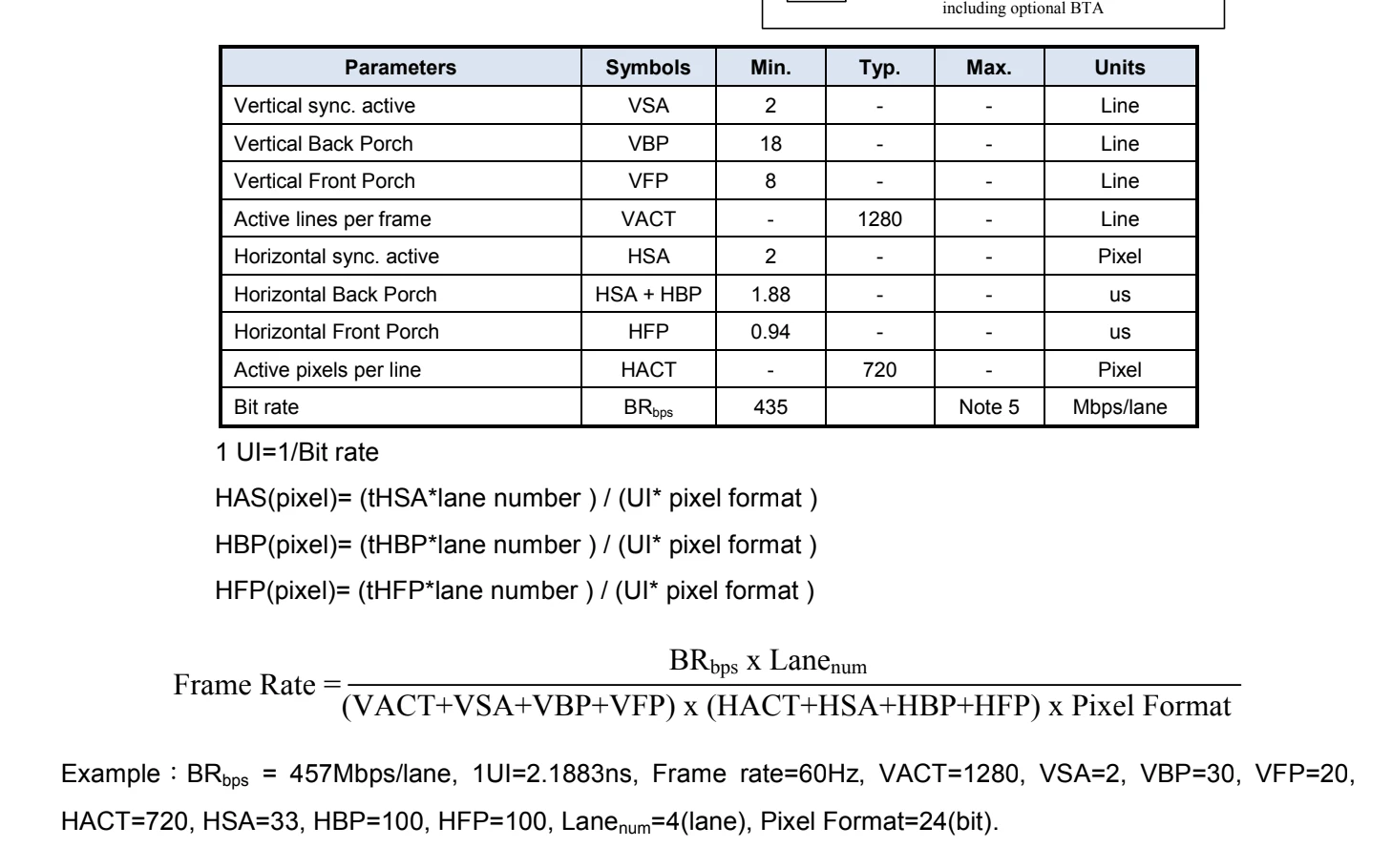

I have display with controller ILI9881C, which controlled via mipi-dsi.
I want to use 800x800x24bit mode. How to understand what's the point to use dsi txclkex and dsi line byte frequency? and how it is correlate with ltdc frequency? in display controller dataheet i have the next description for frame rate
how can i calculate pixel timings for Horizontal Back Porch and Horizontal Front Porch? is it must be based on ltdc frequency?

The line and frame totals drive the​ pixel clock. The rate of data out of the LTDC has to be matched to the lanes and bits going over the DSI based on your colour depth and pixel clock.
Write a "fitter" to get parity in the rates based on the limited clock multipler/divider options. Adjust porches to accommodate within specs of display.​

Just for clarification, must i use LTDC frequency for bitrate ?
in my case - 24 bit on 108 MHz will equals 4.5 Mb/s , right?

The pixel clock for the example there would be 76.2 MHz. with 1.83 Gbps on the DSI
Problem here is going to be you only have 2 lanes, not 4
Is your SDRAM memory interface 16 or 32-bit wide?
Are you doing video play back? What is the hard frame rate for that?

Why a 720p @ 30Hz in example i do not know. Controller have 800 width 0690X00000AqQUpQAN.png
I am experimenting with the next values
FrameRate = 30
PixelFormat = 24
LineN = 2
VACT = 800
VSA = 40
VBP = 100
VFP = 100
HACT = 800
HSA = 40
HFP = 247
HBP = 248
BRbps = 500000000
And calculated
UI = 2e-09
FPS = 30.010563718428887
tHFPCalc=5.928000000000001 us
tHSA + tHBP =6.912000000000001 us
