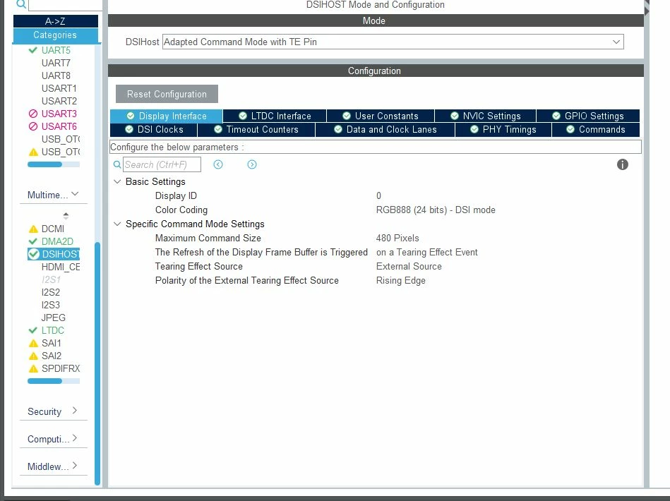

I'm development a board with STM32F779a cpu connect with dsi display.
I create the graphic wit TouchFX tools and included in the STM32cube ide design software.
How example I see STM32f769i-disco demo, and received the init code of display by producer.
My problem is that the DSI Host not run, no signal appare , I'm monitoring with oscilloscopie.
What may be the problem ?

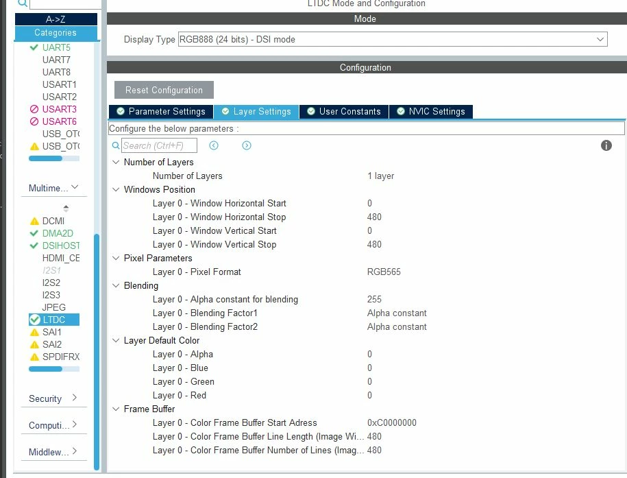

MM..1
May 16, 2023 4:44 PM UTC
Primary all this lines is in bad order in LTDC you start unconfigured DSI
 MX_GPIO_Init();
 MX_LTDC_Init();
 MX_CRC_Init();
 MX_DSIHOST_DSI_Init();
 MX_FMC_Init();
 MX_QUADSPI_Init();
 MX_DMA2D_Init();
PZamb.2
PZamb.2Author
May 17, 2023 5:56 AM UTC
Hi yes is true but is the automatic compiler, all run i must move DSIhost under LTDC
I modify the interface protocole to DSI 24Bit (Display datasheet is poor of information) and now the signal run.

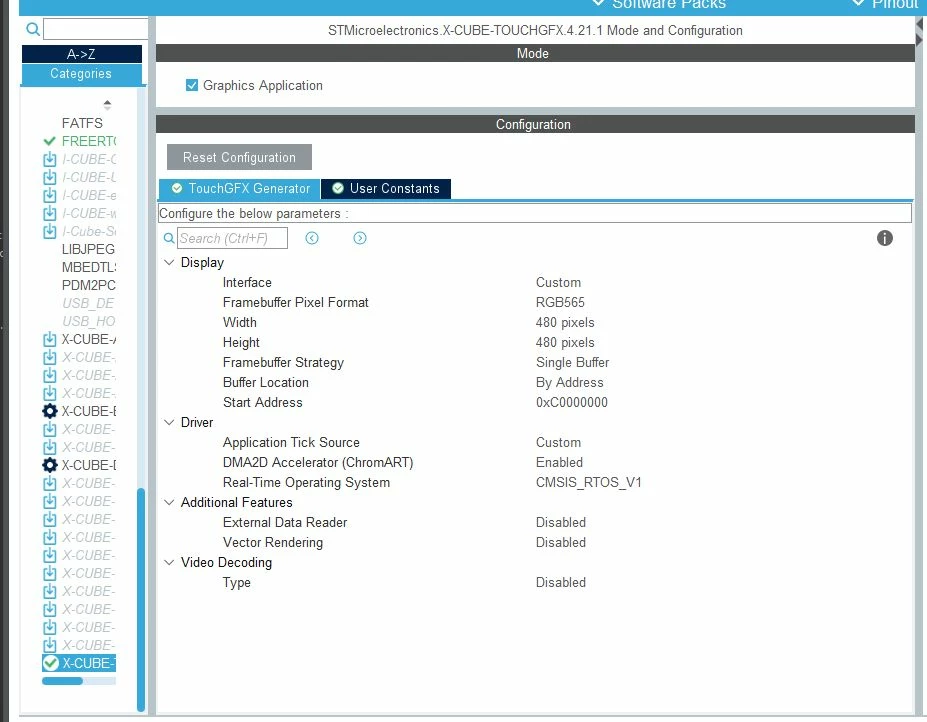

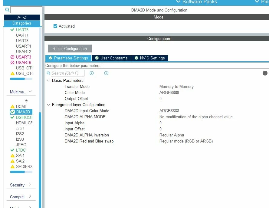

I don't understand because the TouchGFx application doesn't work.
I try with another application board based of same cpu but different display , i think of configured all device , memory Sdram work and external flash is loaded, configuration string from display productor.
The Touchgfx not start, i place the breakpoint to screenviewbase.cpp but the routines doesen't call.
PZamb.2
PZamb.2Author
May 18, 2023 8:46 AM UTC
I chage the position but not work
May be some parameter is wrong
