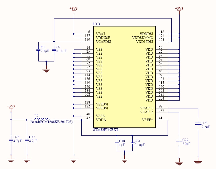

I used STM32F769I-EVAL board as a design reference for custom board. However, I could not achieve correct operation of MB1166 LCD board
which is connected via DSI. It works well on the evaluation board.
When MCU tryies to display a picture, screen fickers with coloured lines and stays white.

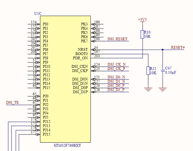

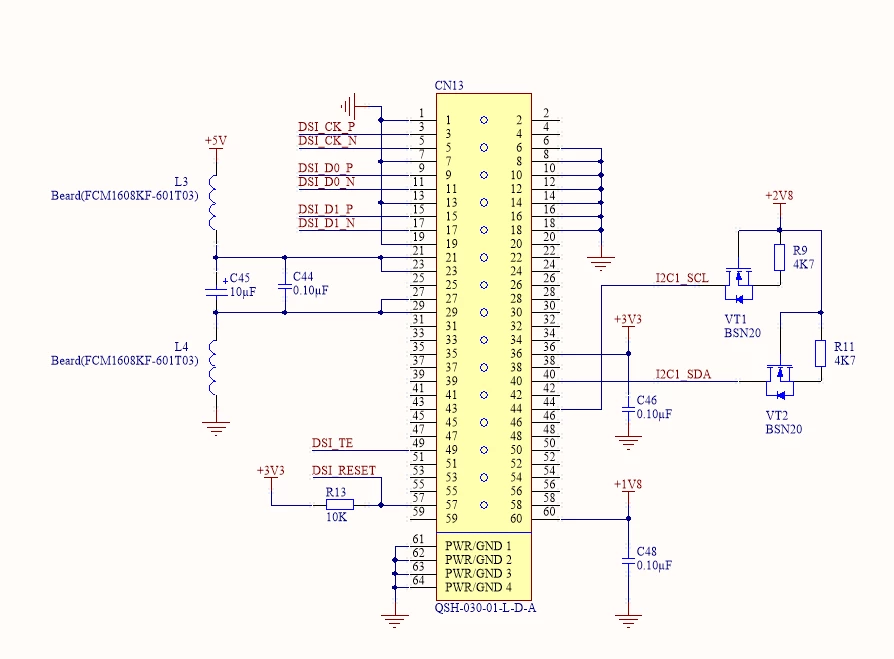

Theres some hardware problem which I cannot figure out. Im attaching custom board schematics of DSI peripheral. STM32F769BIT6 MCU is used.
Any help to debug such issue would be apriciated.

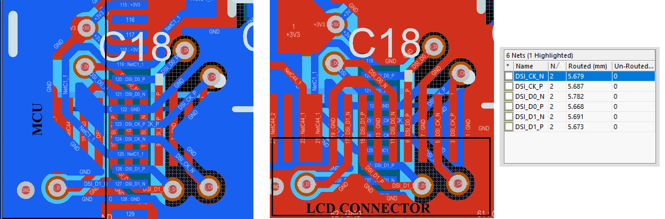

Schematics looks fine at first glance, did you double check layout for footprints missmatch and doubled check the differential pairs for proper routing?

footprints are correct. I figured that DSI routing could have been a problem on my first PCB design. So this time I designed around the DSI. My approach was to reduce length of DSI route as short as possible while maintaining DSI_CK, DSI_D0 and DSI_D1 lengths as equal as possible.
Im attaching PCB routing of DSI connection and DSI net lengths.

Perhaps have an ST FAE review the PCB and trace layout/lengths, circuit performance likely to be critical at these speeds.​
