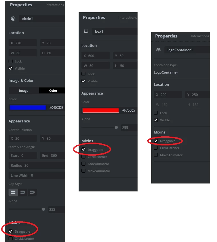

draggable circle
I would like to enable the dragged of the circle only in the horizontal direction for a customized container on which I only have a circle. I would also need to limit the left and right "stop" when dragging. I set up draggable and I can move the circle freely. Can you advise? Can I find a exaample somewhere?
Thank you

One way to achieve this functionalilty is to little bit expand the draggable- class.
Locate folder \Middlewares\ST\touchgfx\framework\include\touchgfx\mixins\ and backup Draggable.hpp (rename to Draggable.hpp.org for example or copy it somewhere).
Then download the attached  Draggable.hpp file and place it to the \Middlewares\ST\touchgfx\framework\include\touchgfx\mixins\ - folder.
In this extended versio there is new function setDragLimits(int xStart,int yStart,int xEnd,int yEnd) which can be used for setting limits to any widget or container. Few examples:

Here are the settings for widgets and container:
Please note that 'draggable' must selected, otherwise setDragLimits-function call will give error. LogoContainer is simple container which holds just one image.
Modified draggable.hpp file is tested in 4.21.4 but it should work also in later versions. Its also possible to manually make same changes and additions to your local file.
