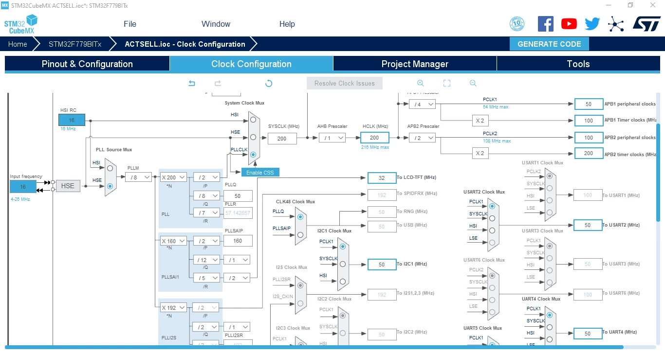

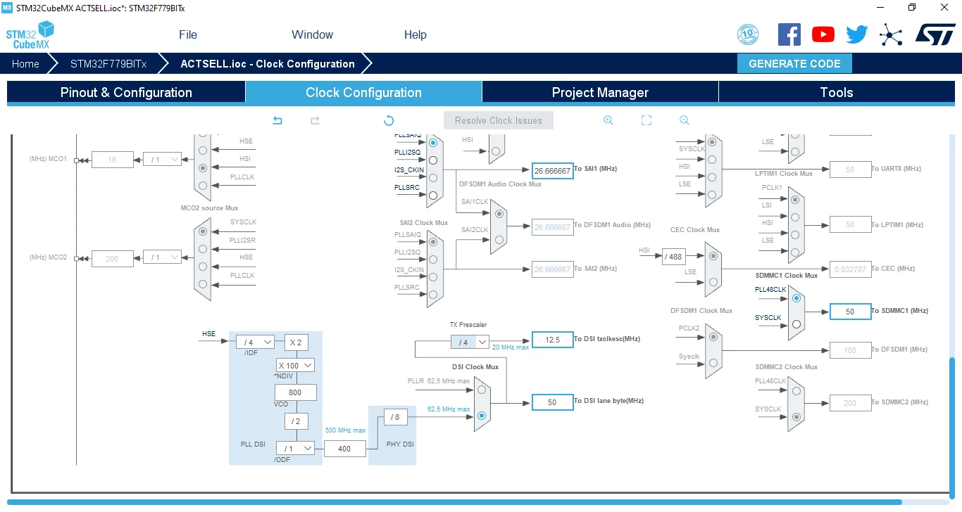

This is my clock configuration, I'm using DSI Host in video mode:
Regarding the flushing I mean that the HardFault appears after completing the first flushFrameBuffer() function from TouchGFXGeneratedHALl.cpp, it occurs exactly after the funcion Application::cacheDrawOperations() that it's entered as soon as the flushing is done.
Thank you
