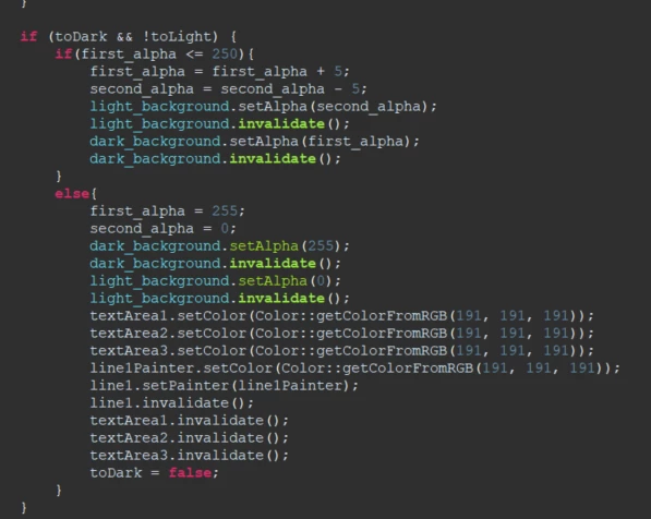

Some example from STM32CubeIDE:
Code on simulator and STM32 Discovery works fine, but STM32CubeIDE don't suggests any functions after pressing ALT + Space

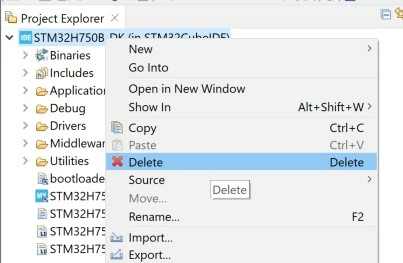

Hello @MSzła.1 ,
It is possible that sometimes when you modify your project and add new code to it, the project in CubeIDE or Visual Studio do not update correctly to accommodate your new code. First please make a backup of your project, then remove your project from the CubeIDE workspace (by right-clicking and selecting delete).Removing Project from WorkspaceRemoving Project from Workspace
After that, delete the build, config, and generated folders from your TouchGFX folder, and finally, regenerate code from the TouchGFX designer. Now, if you open your project again in CubeIDE, the Scalable image should be recognized.
Please update us with the result of this solution.
