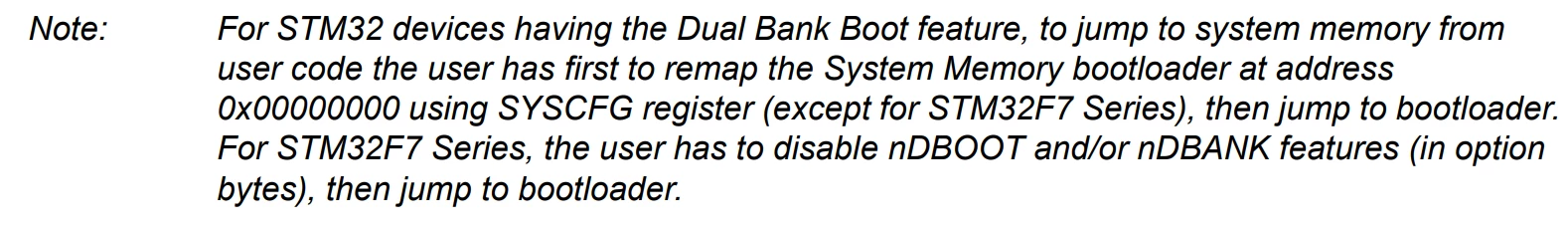

Jan 12, 2023 1:10 PM UTC
Hi @MAmem.1​,
I can't see any issue. I suggest you to take a look at AN2606 section 4.1 Bootloader activation. It might help.
To give better visibility on the answered topics, please click on "Best answer" on the reply which solved your issue or answered your question.Best regards,FBL
