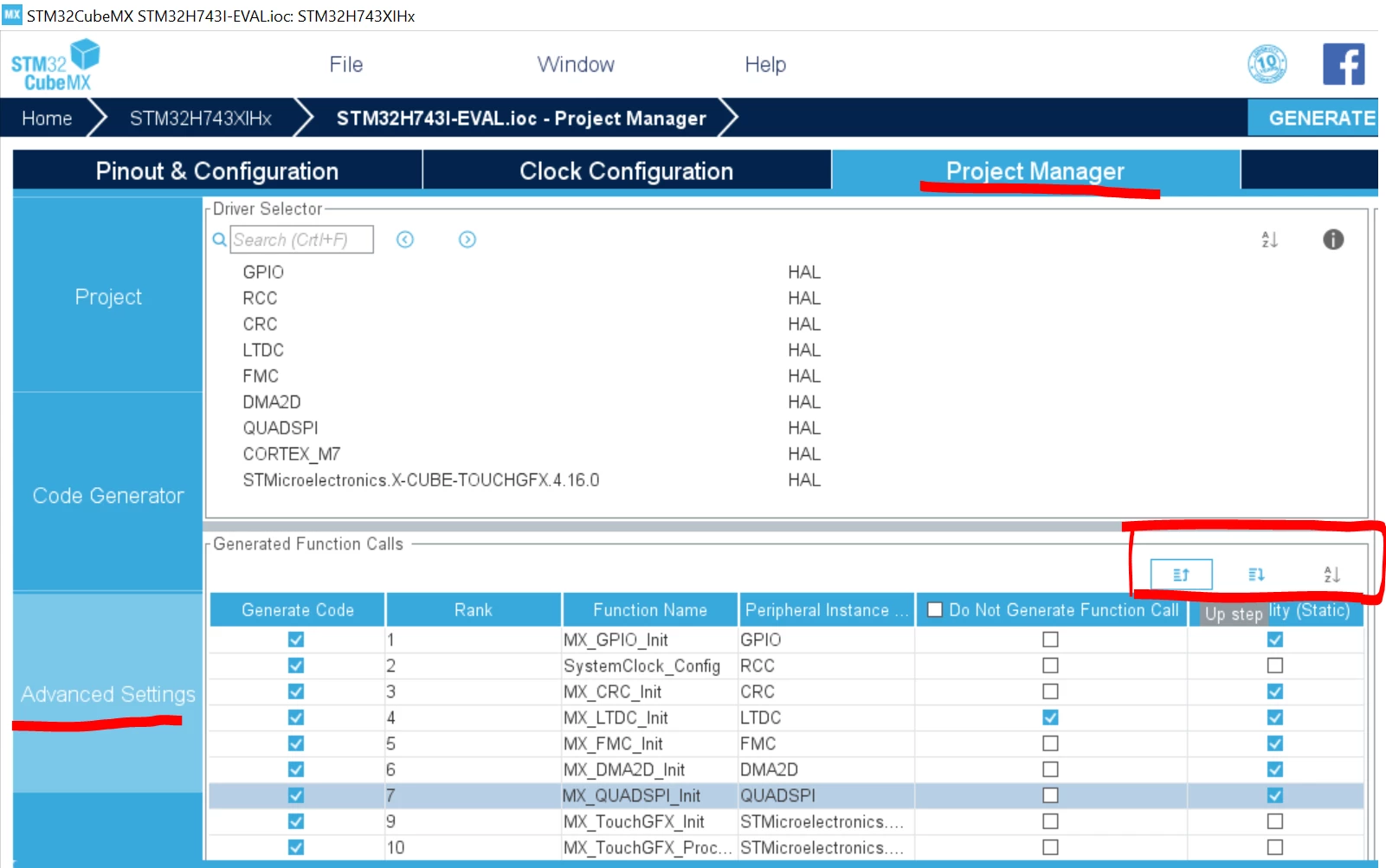

In CubeMx, Project Manager tab -> Advanced Settings, the "Do Not Generate Function Call" for MX_TouchGFX_Init is not working.
After selecting it and generating the code, the MX_TouchGFX_Init() is still present in the main.c and going back to the Advanced Settings, the previously selected check box got deselected.
This is a problem because when using the QuadSpi with TouchGFx, it needs to be mapped before TouchGFX initialization.
The mapping cannot be made in the MX_QUADSPI_Init because there is no USER CODE section at the end of this function (Hey ST, what about having a user code section at the end of EVERY HAL init function???).

Thank you for reporting this. I am surprised by it as well as I could replicate the issue on projects on a STM32H743 eval board and on a H7b3 dk board. It seems that only the MX_TouchGFX_Init is not working, we will investigate more on that (might be just me not aware of a step to do). Could you add the topic "CubeMX" in the Topic tags of this post ? That way this will have more visibility.
Are you working on a custom board ? Did you start your project from scratch from CubeMX ? I am asking this because from what I understand from your message, you have the MX_TouchGFX_Init called before the MX_QUADSPI_Init ? This is not the case in the application template for the H743 eval board available on TouchGFX Designer. I believe the issue might come in your case from the "rank order" of your functions: you can see that in the Project Manager tab -> Advanced Settings --> Generated Function Calls. You can change the ranks of the function by selecting a function and pressing the "up or low arrows" on the top right (see picture)

franck23
franck23Author
January 20, 2021
Hi Romain,
Thanks for the answer.
(CubeMX is now added to the topic).
Yes, I am working on a custom board, starting from scratch with CubeMX.
The MX_TouchGFX_Init is indeed called after the MX_QUADSPI_Init.
However, the bit of code to map the QSPI must be after MX_QUADSPI_Init and before MX_TouchGFX_Init.
The best place to add this code would be at the end of the MX_QUADSPI_Init function, but this is not possible because there is no "user code" section there.
What I have done now (and is working) is that I selected the "Do Not Generate Function Call" for the QSPI instead and moved the call to a user code section earlier in the main ("USER CODE BEGIN SysInit"). Then I do the QSPI mapping.
