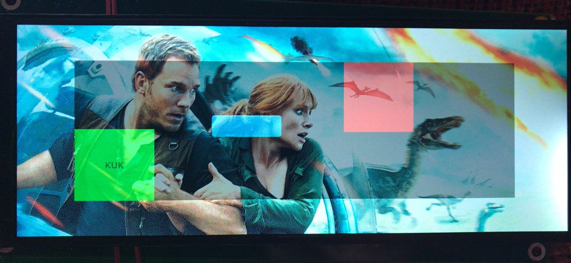

I also have a 800x480 LCD connected to a F767. I use 8MByte of external DRAM for the framebuffers. For performance reasons I put each of the 3 framebuffers in a separate RAM-bank (2MByte). But I think this would also work with the framebuffers aligned contiguous.
STM32F767BITX_FLASH.ld:
.sdram_bank0 0xC0000000 (NOLOAD) : /* MPU configured to Normal, Write through, no write allocate, shareable */
 *(.tgfx_framebuffer0)
 . = ALIGN(32);
 *(.sdram_bank0)
} >EXT_SDRAM
.sdram_bank1 0xC0200000(NOLOAD) : /* MPU configured to Normal, Write through, no write allocate, shareable */
 *(.tgfx_framebuffer1)
 . = ALIGN(32);
 *(.sdram_bank1)
} >EXT_SDRAM
.sdram_bank2 0xC0400000 (NOLOAD) : /* MPU configured to Normal, Write through, no write allocate, shareable */
 *(.tgfx_framebuffer2)
 . = ALIGN(32);
 *(.sdram_bank2)
} >EXT_SDRAM
TouchGFXHAL.cpp:
uint8_t framebuffer0[2][DISP_FRAMEBUF_HEIGHT][DISP_FRAMEBUF_WIDTH_PITCH] __attribute__((section(".tgfx_framebuffer0"))) __attribute__((aligned (1024)));
uint8_t framebuffer1[2][DISP_FRAMEBUF_HEIGHT][DISP_FRAMEBUF_WIDTH_PITCH] __attribute__((section(".tgfx_framebuffer1"))) __attribute__((aligned (1024)));
uint8_t framebuffer2[2][DISP_FRAMEBUF_HEIGHT][DISP_FRAMEBUF_WIDTH_PITCH] __attribute__((section(".tgfx_framebuffer2"))) __attribute__((aligned (1024)));
