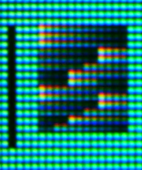

Here is a close-up of the distorted characters (on cyan background to visualize where pixels were written:
0693W000006HLERQA4.jpgThis image shows the gradient character. The black line next to it shows how tall the character is supposed to be. This is the only character from the transfer that was started outside of the DMA2D interrupt.

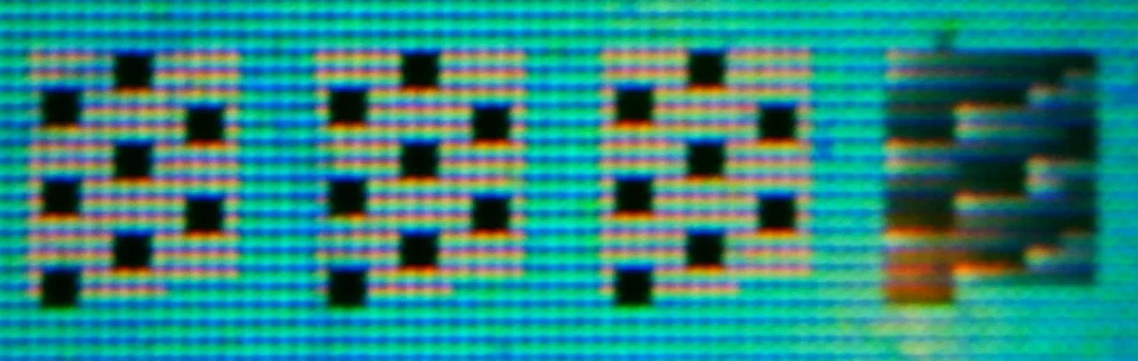

0693W000006HLEbQAO.jpgThis image shows three of the of the vertical line characters and one more gradient character. The reddish hue on the last character is just some dirt, sorry about that.
The vertical line gets chopped up into 2x2 squares distributed all over the visible character. The gradient also shifts about every two lines. Interestingly, the characters are not fully drawn. Depending on the character (and whether or not the character was drawn already), some of the bottom lines may be fully or partially missing. Additionally, the shifting looks different depending on whether the MCU is cold-booting or reset using the NRST pin.
A closer look at the gradient characters shows that 4 pixels seem to go missing at a time, though I only checked the first few lines since it is sometimes not clear which pixels are missing.

My guess is, that the FMC setting violates the LCD controller's back-to-back write specification. Try to increase FMC cycle time, by whatever means (probably by increasing FMC_BTRx.DATAST or ADDSET).

Yes, that makes sense.
Here are the write timings previously used for the FMC:
// Write Timings
timingAdv.AddressSetupTime = 0; // Min 0 / 0ns
timingAdv.AddressHoldTime = 15; // Not used
timingAdv.DataSetupTime = 2; // Min 1 / 10ns
timingAdv.BusTurnAroundDuration = 2; // Min 2 / 15ns
timingAdv.CLKDivision = 16; // Not used
timingAdv.DataLatency = 17; // Not used
timingAdv.AccessMode = FMC_ACCESS_MODE_A;
I have configured the FMC to be clocked by PLL2R. PLL2R is configured to run at 100MHz. The clock initialization code is based on the generated code from STM32CubeMX.
According to ILI9486L datasheets I could find, the current timings should be correct by themselves. The datasheet calls for a write cycle time of 50ns. My interpretation of the datasheet was that the total clock periods per write cycle were equivalent to BUSTURN+ADDSET+DATAST+1. This would provide the required 50ns. As it turns out, I thought that MODE A caused BUSTURN to always be applied, even when larger transactions are split (since DMA2D is probably using 32/64 bit transactions), but this is only the case for MODE D. Instead of switching to mode D, I increased ADDSET to 1 and DATAST to 3, resulting in the following code that works:
// Write Timings
// Write cycle min. 50ns / 5 cycles
// Calculated as ADDSET+DATAST+1
timingAdv.AddressSetupTime = 1; // Min 0 / 0ns
timingAdv.DataSetupTime = 3; // Min 1 / 10ns
I have also lowered the DMA2D AMTCR DT to 1, since the FMC will now properly limit the speed.
The rectangles now render to exactly one quarter of their intended size, which is probably an unrelated bug.
Thank you!
