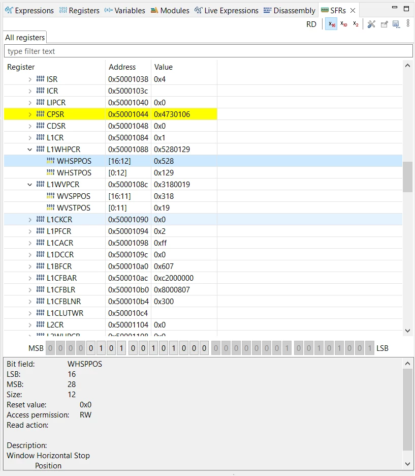

Here's my LTDC and DMA2D init functions for 1024x768 screen size and RGB565 mode generated from STM32CubeMX using LL:

Seems that Window Horizontal Stop is equal to 1024. But, somehow, the problem still exists...
The value in Layer1 WHSPPOS register is 1320 including horizontal back porch value.
_legacyfs_online_stmicro_images_0693W00000bkpUbQAI.pngMaybe this is the reason...
Thanks for your attention.
KDJEM.1
May 25, 2023 12:40 PM UTC
Hi @mrnukeab​ ,
Thank you for these details.
For example if the LTDC_BPCR register is configured to 0x000E0005 (AHBP[11:0] is 0xE) and the LTDC_AWCR register is configured to 0x028E01E5 (AAW[11:0] is 0x28E). To configure the horizontal position of a window size of 630x460, with horizontal start offset of 5 pixels in the active data area:
1. layer window first pixel, WHSTPOS[11:0], must be programmed to 0x14 (0xE+1+0x5)
2. layer window last pixel, WHSPPOS[11:0], must be programmed to 0x28A.
Thanks and best regards,
Kaouthar

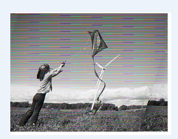

snguy.1
Dec 30, 2023 1:22 AM UTC
Hi Alex Gab
Have you finished the jpeg decode and DMA2D project yet? I am working about them. I have a problem about using JPEG decode and DMA2D. You can fix for me, thanks?
Below is the process I follow:
Step 1: Convert Hex data of Image JPEG from file.h from flash memory
JPEG_Decode_DMA(&hjpeg, (uint32_t)image_320_240_jpg, IMAGE_320_240_JPG_SIZE , JPEG_OUTPUT_DATA_BUFFER);
while(Jpeg_HWDecodingEnd == 0){
Step 2: Use DMA2D convert YCBCR to RGB888
DMA2D_CopyBuffer((uint32_t *)JPEG_OUTPUT_DATA_BUFFER, (uint32_t *)LCD_FRAME_BUFFER, JPEG_Info.ImageWidth, JPEG_Info.ImageHeight);
while(Flag_Dma2d_complete==0){
Step 3: Send data of LCD_FRAME_BUFFER to computer by USART
unsigned char *p;
p = (unsigned char*)LCD_FRAME_BUFFER;
for(i=0; i<(JPEG_Info.ImageWidth*JPEG_Info.ImageHeight*3); i++)
HAL_UART_Transmit(&huart1, p+i, 1024, 5000);
i += 1024;
IWDG_ReloadCounter();
Step 4: Convert data give from USART to image rgb888 on QT5 tool and show on label and Image I have then:
I don't know where is wrong, color of image false, all image as gray.
This is full my code:
