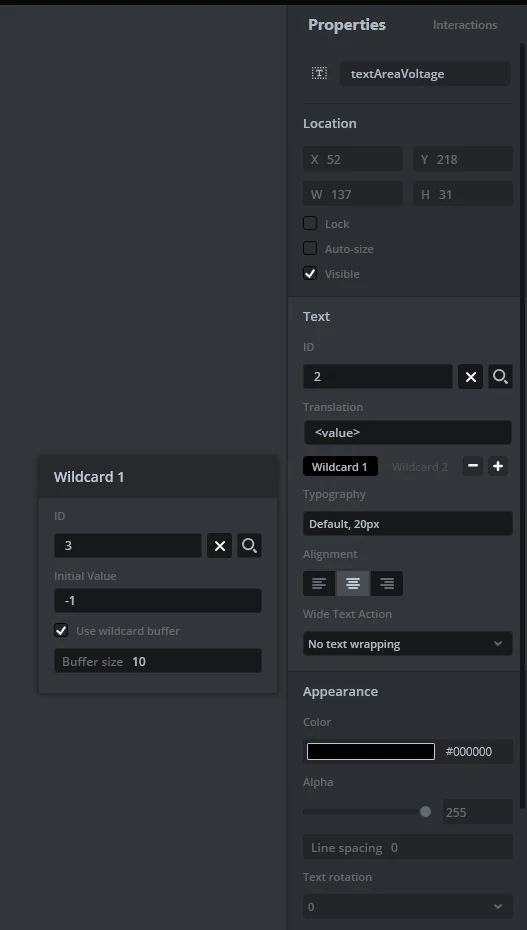

I am a noobie and I am just starting out with TouchGFX. I have designed a 7 screen gui which cycles between screens (1-7 in that order which cylces indefinitely) and I have a text area which I want to populate with real-time data. This is only on screen 4 and 6 and I have defined the wildcards in the designer as follows:

void Screen4View::UpdateVoltage(float value)
	Unicode::snprintfFloat(textAreaVoltageBuffer,sizeof(textAreaVoltageBuffer), "%.2f V", value);
 textAreaVoltage.invalidate();

Ok, so I have worked on it longer and I have gotten to this point:
I call a function in my Screen6View.cpp which I want to update the wildcard value in the gui.
This is how my code looks:

void Screen6View::UpdateCurrent(float value)
	Unicode::UnicodeChar buffer[6];
 Unicode::snprintfFloat(buffer,sizeof(buffer), "%.2f", 3.15345);
	textAreaCurrent.setWildcard(buffer);
	textAreaCurrent.invalidate();
When I debug my board, I can see that I am entering the UpdateCurrent function. I set the Initial value of the wildcard to be -1 and ass soon as I call my UpdateCurrent function the wildcard updates to the fallback character of the wildcard which I set to be '-' in touchGFX.
