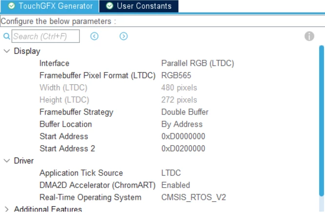

Firstly, I am a beginner when it comes to using STM32 microcontrollers. For my final-year project I intend to implement a GUI using my the abovementioned board to display ADC values. I followed the prompts of a video on YouTube where TouchGFX and STMCubeIDE are used. In place of STMCubeIDE, I used Keil.
The video uses one ADC input, whereas I need four. I built a code that compiles (attached). My problem is that I even after loading the code onto my board and pressing the reset button, the display is still blank (white). What could the underlying cause(s) of this be? Any assistance will be greatly appreciated as this is a pressing matter.

Usually when you have a white display it means that you hit hardfault. Have you tried debugging and going step by step ?
What is the revision of your board ? From the project you shared I see revision D but i just want to be sure you chose the right one.
Were you able to display things before working with all the ADC inputs ?

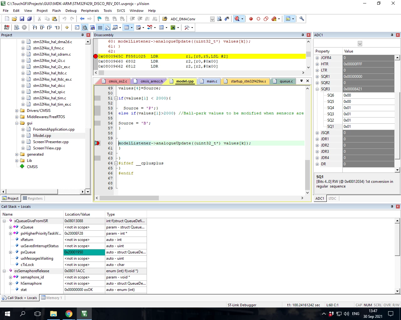

, are you familiar with the debugger tool?
place some breakpoints and read the adc yourself without the need of screen.
we need to know what tutorial are you following.

:beaming_face_with_smiling_eyes: I am familiar with the debugger tool ( to an extent).
This is what I see regarding the registers:
Also, alluding to the tutorial I tried: https://www.youtube.com/watch?v=EbWOv_0Lp-U

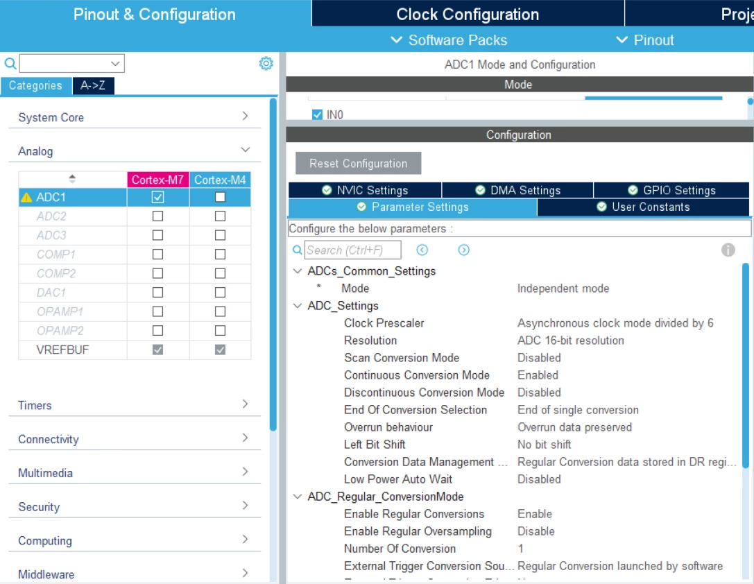

Visitor II
Aug 16, 2023 1:04 PM UTC
  • If somebody find the solution for this issue ? Can you share your solution please ?
I am using :
  • CubeMx version 6.7
  • Cube IDE version 1.11.2
  • TouchGFX designer 4.21.3
  • STM32H745 DISC0 board
My first project without ADC was working well. I was able to display animation on the HMI. But since I added the ADC, the screen is blank. After debug, I can see the tasks are running well, even the TouchGFX task also is running. But the display is blank.
