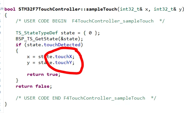

Attached is my BSP drivers for my custom board with STM32F7508N MCU and RK043FN66HS-CTG display with gt911 touch driver implemented. The code is still a little messy and needs a cleanup. It's working good for me. You just need to do a little change on sampleTouch function (as on attached image) and include the stm32f7508_discovery_ts.h on STM32F7TouchController.cpp file. I've made some changes on componets code, under BSP files, so a recomend you to use all my BSP drivers...).
Please let me know if it works!

It all worked fine using the given files.
João Costa
January 23, 2020
Hi @YAdan​ ! Glad to know it! Thanks for reply...

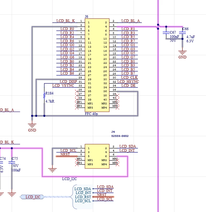

Hello Sahil Ahmad,
I hope you know this post concerns only custom boards using RK043FN66HS-CTG LCD.
Find below the two connectors pinout for my LCD side.
On the MCU side I am using a diffrent package than the discovery board but should be the same.
The NRST is connected to NRST pin and INT to PI13. But I guess this you know,
I hope that helps.

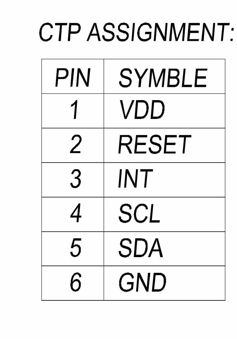

Dear Expert,
I am using RK043FN66HS-CTG in my device as a manufacturer.
However, there is Supply issue at manufacturer issue and as such I am looking at an immediate alternate.
I have found some models from Tianma Corp. similar to my 4.3 TFT LCD but the pin is different and doesn't comply to my pcb.
I am in big problem I cant change my design all of a sudden and as per market available LCD+ TP.
Can anybody in this community help me to find my exact CTP match in any LCD maker in this world.
Any solution for this is highly recommended.
MY PIN as attachment below.0693W00000BaTa5QAF.jpg.
