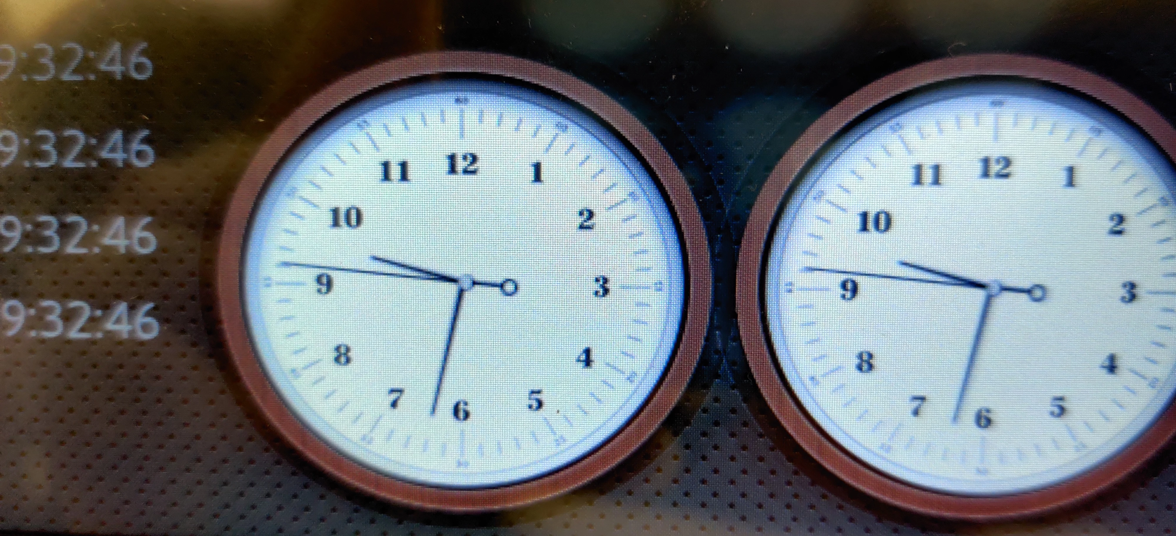

2. Second issue is object skewing, object appears perfectly fine on TouchGFX designer , but downloaded objects are skewed on y axis. What could be the root cause and How can I avoid this ?

  2. Please show me some example of this. Sounds like porch setting issue.

2. Please find attached file, where you can see clock dial is skewed on y-axis.
