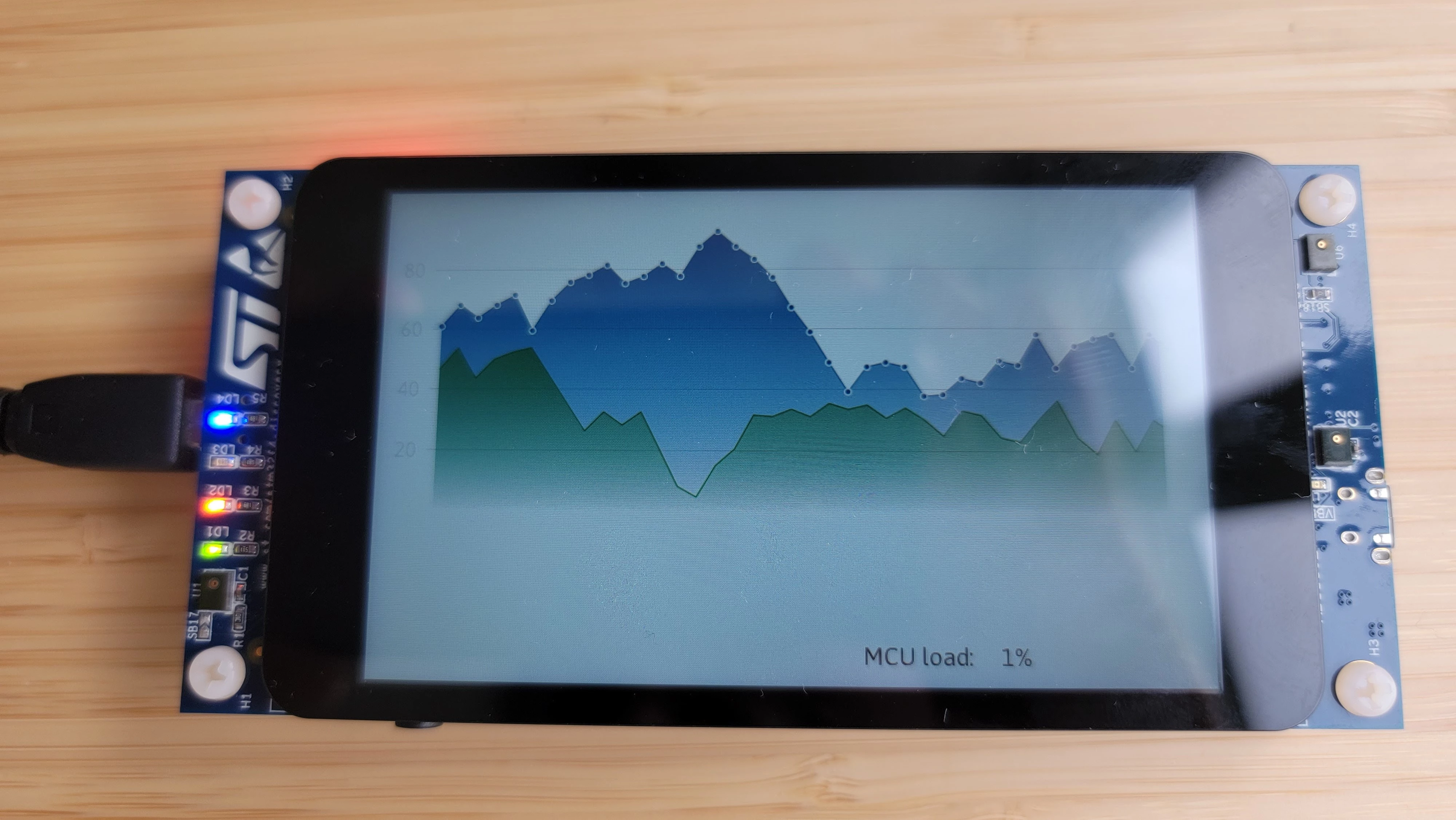

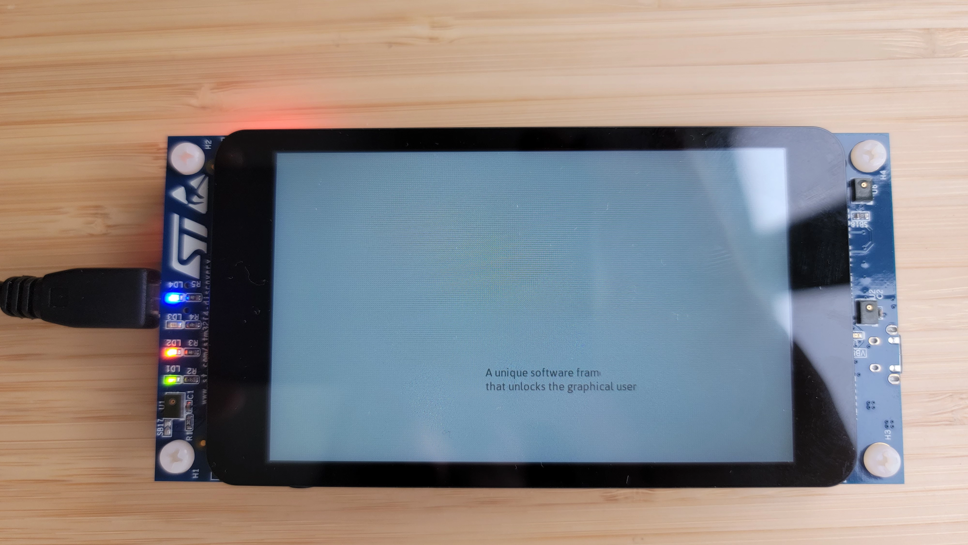

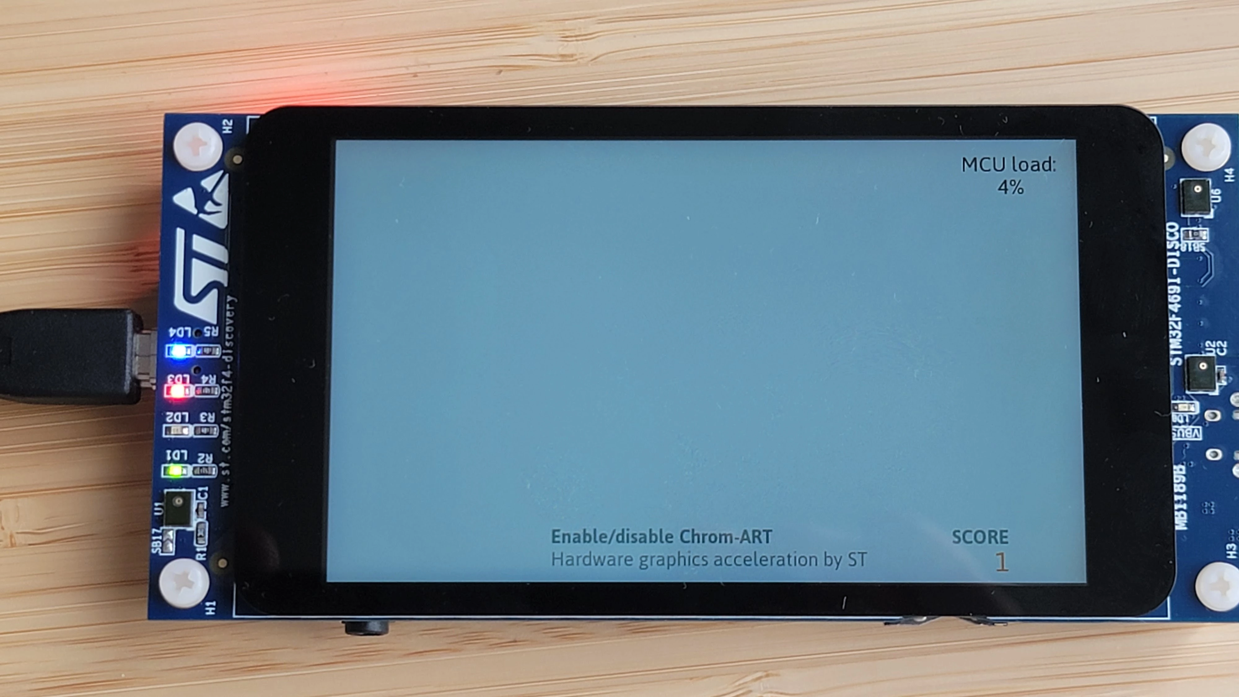

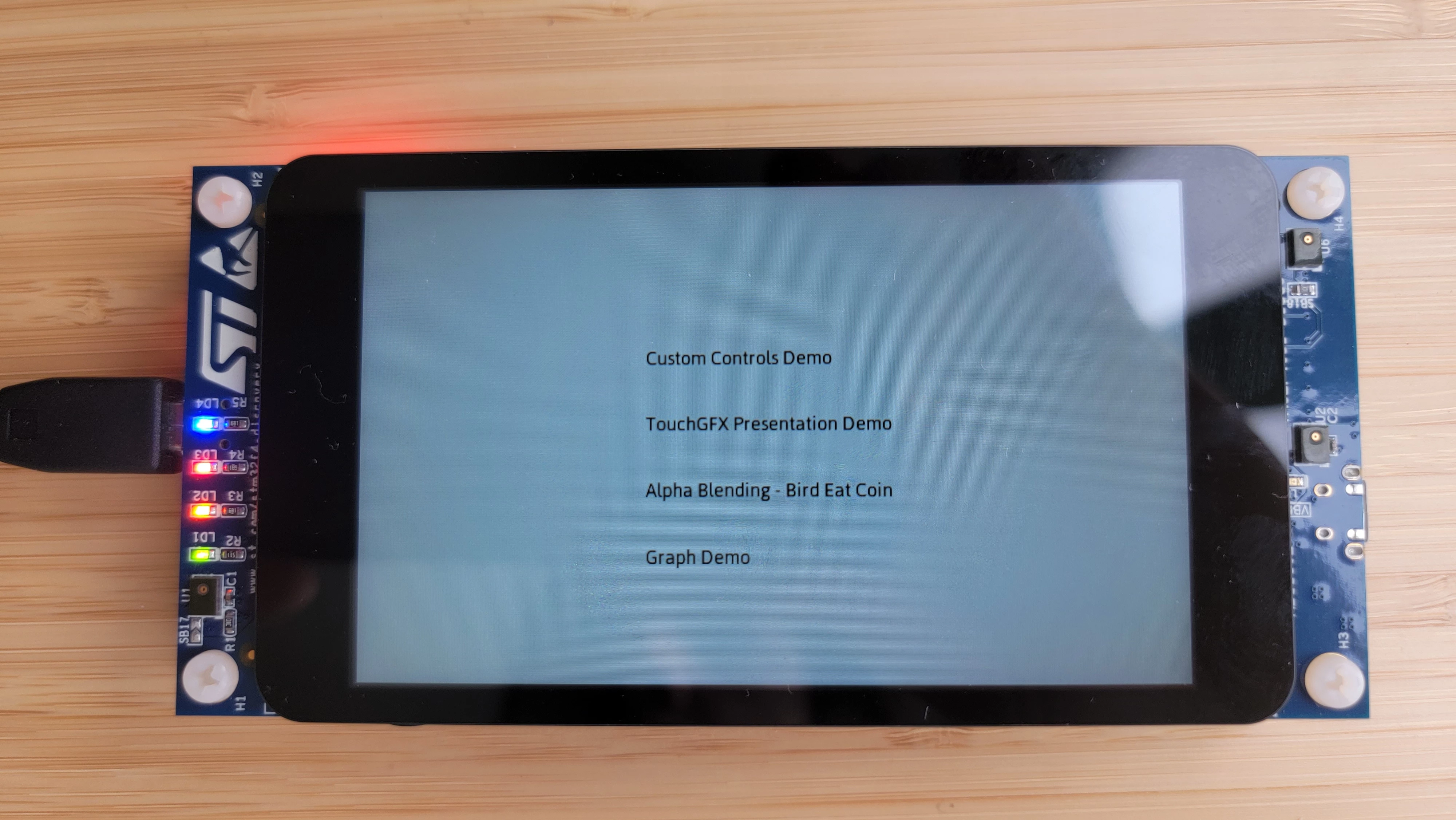

I am trying to run the TouchGFX example from STM32CubeIDE on the STM32F469I-DISCO board. Everything compiles and I am able to flash the target. However, it looks like many items from the menus are missing, see a few pictures of how the menus look like.
Main screen:
TouchGFX Presentation Demo screen:
Alpha Blending - Bird Eat Coin screen
Graph Demo screen
Is there anything that could explain so many parts not moving? Touch inputs seems to work (swipe, scroll, touch).

Looks like you haven't flashed the resources part - images etc. Most likely those are located on the external 16 MB Quad-SPI FLASH chip.

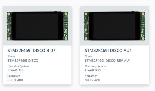

Nov 1, 2023 12:19 PM UTC
