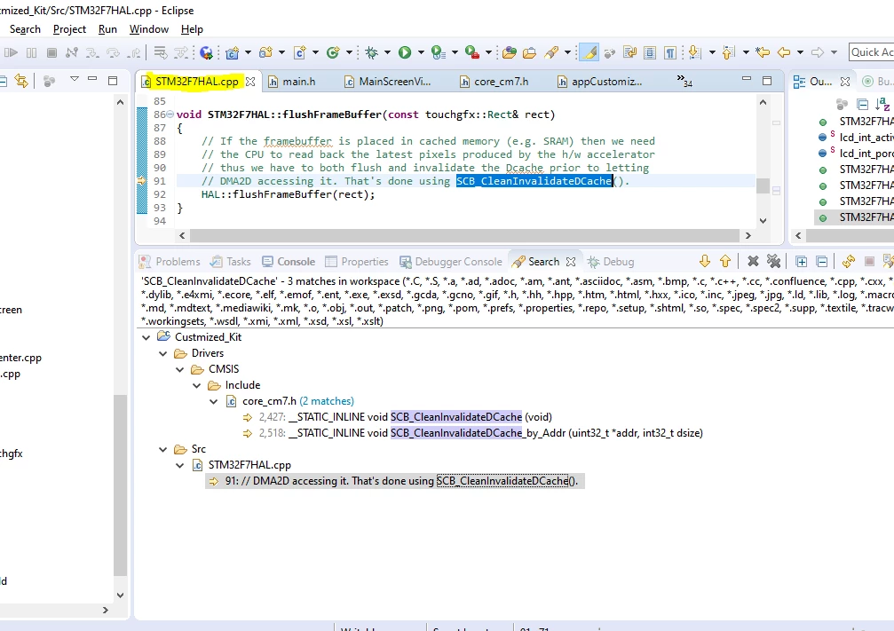

Also uncomment all the lines where you have SCB_CleanInvalidateDCache(); (They should be located in STM32DMA.cpp and TouchGFXHAL.cpp).

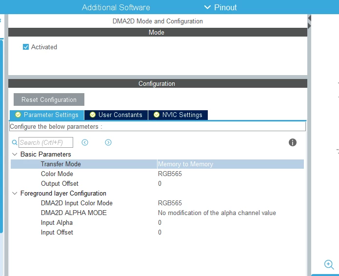

@Alexandre RENOUX​  Hi, I am using custom board with MCU 746 with below software with version :
  • Touchgfx 4.15.0
  • CubeMX 5.4.0
  • IDE : System workbench for STM32
Below are the settings for DMA2D
In My project, I searched for SCB_CleanInvalidateDCache(), but I am not directly calling it anywhere.

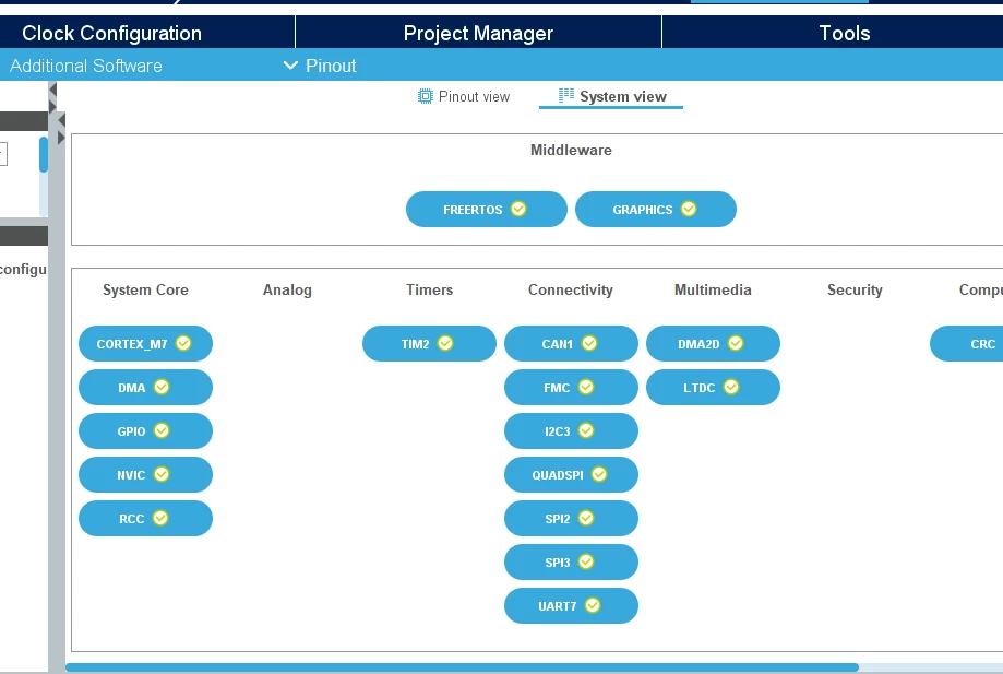

0693W000006HUiLQAW.pngI didn't enable MPU. Check my system view.
Alexandre RENOUX
Visitor II
January 5, 2021
MPU needs to be enabled. Please refer to the Application Template F746-DISCO available in TouchGFX Designer.
