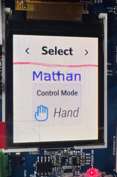

I am using the STM32H563 with an ST7735S display and encountering a colour difference between TouchGFX and the display. How can this issue be resolved?

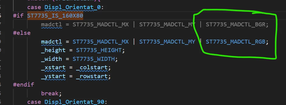

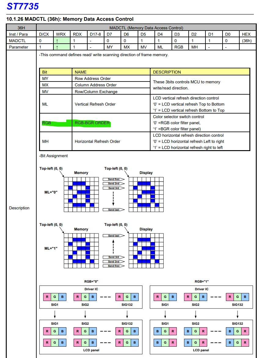

The ST7735 has a register called MADCTL (Memory Access Data Control), address 0x36. Notice that one of the bitfields is the RGB/BGR Order. You could try toggling this bit, which will tell the driver to interpret the red and blue channels opposite to what they currently are now.
In your project file drv_st7735.c, check the DRV_ST7735_SetRotation function. Notice that some pre-processor "if" sections set the madctl variable to the ST7735_MADCTL_RGB define and some others set it to ST7735_MADCTL_BGR.
Try swapping the ST7735_MADCTL_RGB with ST7735_MADCTL_BGR and vice versa for all rotation cases.

Most likely the drivers of your screen don't use the same format as TouchGFX.
For instance, TouchGFX uses ARGB but your display's driver might be in ABGR.
