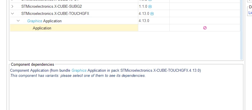

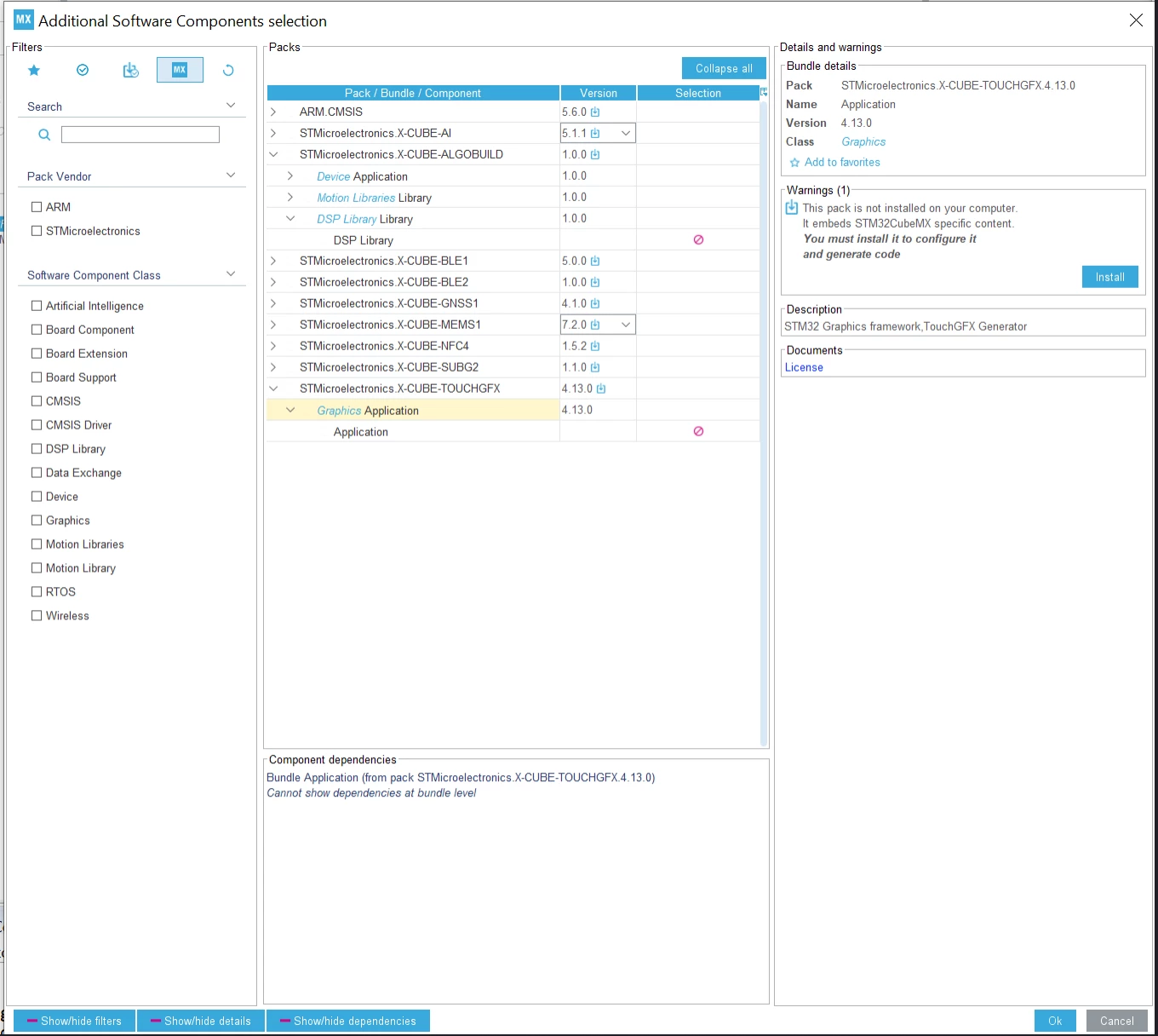

I am trying to download the TouchGFX pack within STM32Cube IDE. I'm probably doing something wrong but nothing I click on seems to do anything at all.
I can see a message asking me to select a variant but I can't see a list (unless it means the bottom line: 'Application'). If I click 'Install', the window just closes and nothing happens regardless of what I select. When I tried the DSP package, I got the same result.
In case it makes any difference I am doing this for a custom STM32G474CET6 board.
What am I doing wrong?
Thanks.
1 reply
SSton.1
SSton.1Author
July 6, 2020
The answer appears to be that according to https://my.st.com/content/my_st_com/en/products/embedded-software/mcu-mpu-embedded-software/stm32-embedded-software/stm32cube-expansion-packages.html#products, absolutely no packs at all are available for the STM32G4xx - that's really disappointing.
