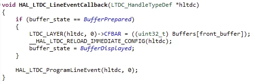

I have spent a very long time removing the BSP initialisation calls from the LCD_DSI_VideoMode_DoubleBuffering example on STM32F469I-DISCO, however it behaves exactly the same using the "stock" example and with my modifications. I am not using TouchGFX.
The symptom is a consistent diagonal tear in a fixed location on my landscape configured display regardless of where the region of the screen I am editing is. Naturally, if the region I'm editing doesn't cross the diagonal, the tear isn't visible. Slow mo video of issue is attached.
In both the example and my modified code, the screen is waiting on HAL_LTDC_LineEventCallback to switch to a new buffer like so:
In my modified code as shown above, Buffers[front_buffer] is written to (using DMA2D) while the state machine is at the state before BufferPrepared, and then the state machine moves on to BufferPrepared 200ms later (same behaviour when this is much higher). 200ms allows the DMA2D plenty of time to complete, so when the interrupt above fires with the buffer state correctly set the data should be stable and unchanging.
So in summary, I have 2 buffers in SDRAM. The DMA2D is only ever writing to the one that the LTDC is not reading. And there's a significant enough delay between the DMA2D operation and the LTDC swapping buffers that the DMA2D must have completed in time. So why does the display end up displaying half (not exactly half, but whatever) of the old buffer and half of the new buffer, split by a diagonal line?

I've had a break through on the issue also, however I still can't explain the original problem. By initialising the NT35510 in portrait mode and configuring the LTDC to be portrait instead of horizontal the problem is no longer present. Of course, now I have an issue that my frame buffer is portrait instead of landscape, but at least I can work around that except when using DMA2D mem-to-mem.

I have to add that even without buffer memory update (using DMA2D or directly) but just swapping buffer address (CFBAR) leads to the same effect. So I can assume that the issue is closely tied to the hardware (defective display or maybe it initially has poor video mode support or poorly designed MCU's DSI/LTDC etc).

For what it's worth, I got a reply from ST on my engineering support ticket that @Tesla DeLorean recommended I submit. They don't think this is a configuration issue, and that the only landscape option with this LCD is the partial refresh command-mode approach (which I note does improve performance, but as they said, does not completely eliminate tearing effects, only helps). Unfortunately command-mode isn't an option for me with my current project aspirations. See full reply:
LCD screen on STM32F469-DISCO board is not adapted for landscape mode. It will scan vertically (horizontal scanning is not available), This is why you have diagonal tearing effect when configured in landscape mode.
One solution we would recommend is to used command mode partial refresh strategy, this will help to avoid tearing effect.
