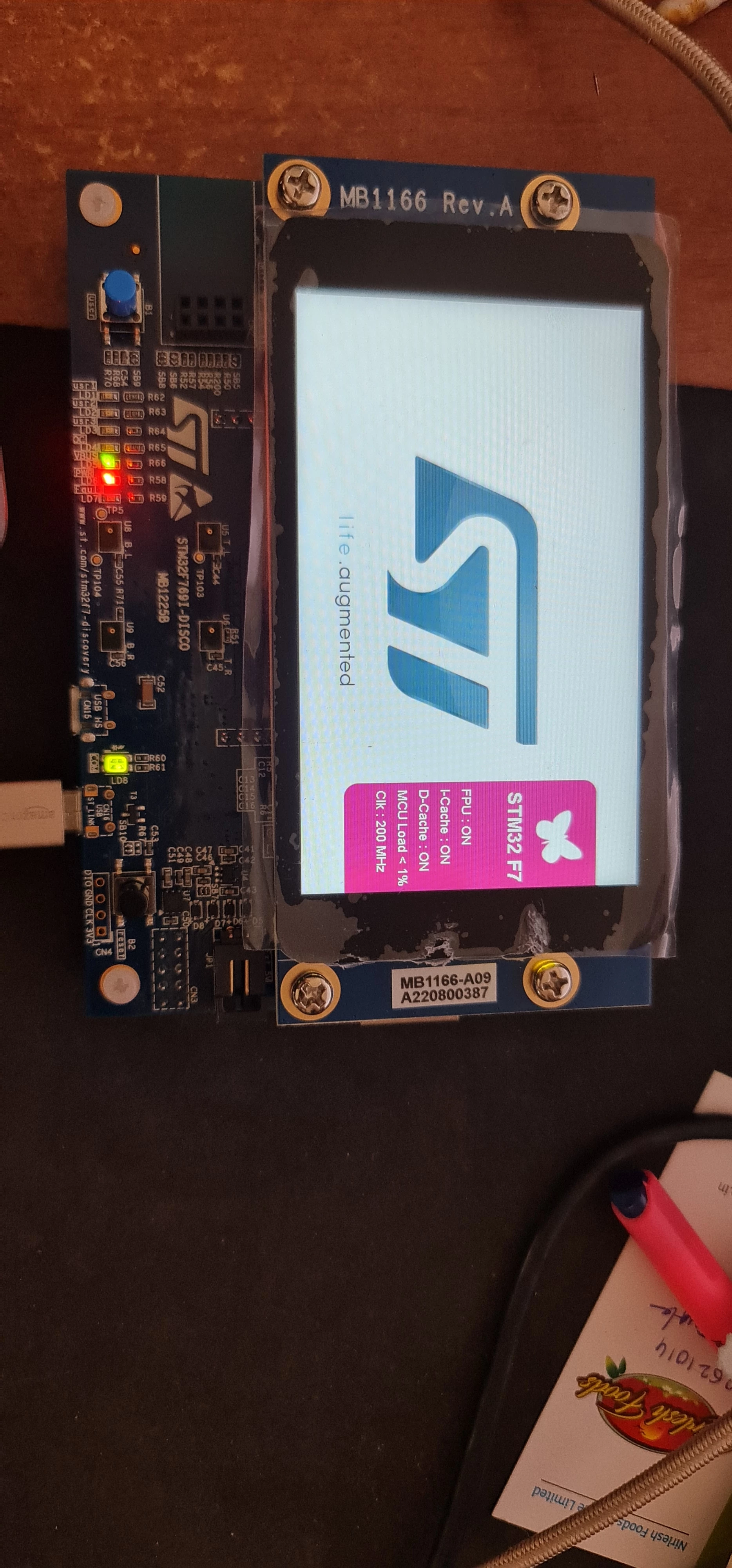

I have purchased STM32F769 Disco Board. Post powering board from CN16 power LED turned on. Nothing appeared on LCD as described in Demo firmware. I reprogrammed FULL demo firmware STM32769I-DISCO_DEMO_V1.0.0_FULL.hex. LCD is struck at Blue logo. Nothing happens after that.

I have went through the readme file and followed the instructions for flashing the full demo firmware. But it is not working. Post flashing I can only see Blue ST Logo.
I have downloaded binaries from
https://www.st.com/resource/en/compiled_demos/32f769idiscovery_demo.zip
If I flash STM32CubeDemo_STM32769I-DISCO_V1.4.0.hex binary from STemWin folder then I see the display as per attached image. It shows ST logo and and cpu specific details. But I cant see other icons showing options like audio or video player.
Not sure if received board has some defect or binaries has some problem.

the company i work for has recently bought the STM32F769 Discovery Board including the LCD-Screen.
After the first powerup the Screen showed only black and only the PWR-LED (LED6) turned on.
After downloading the Demofirmware from the official ST-Website and programming it via the STM32CubeProgrammer following the readme instructions given precisely, the Screen shows the ST-Logo and then stop there and wont show anything else.
did you found a solution for your described problem?
Justin

I think board has some manufacturing defect. I checked with technical team of distributor.
They sent me the replacement. Replacement worked perfectly.
To debug I built multiple binaries from STM32Cube7 software package but nothing worked. Looks like some bad component (may be audio related) on board prevents firmware init process.

thank you for your quick reply. Haven't thought about manufacturing issuses yet but the example projects given in Keil µVision (the toolchain we are working with) also just create random coloured pixels all over the screen. I'll do some debugging as you suggested.
Did you connect your supplier or ST-Microelectronics directly?
Justin

Check the board user manual revision history chapter. BOM may have changed and the demo sw waa not updated?

I just checked the exact board revision of my board and it is MB1225-F769I-B03.
For this board theres is no demosoftware available as stated in the user manual document "UM2033".
So you are right. Thanks for your time and the reply.
