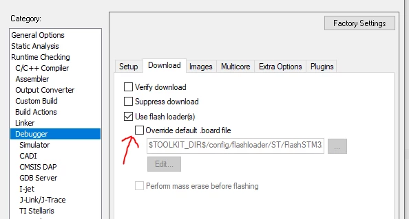

Working on touchGFX project (ide: IAR workbench 8.40) for STM32H750B-DK board and its working (generate code, run simulator, run target from TouchGFX generator tool) as well as successfully build in IAR also. But I couldn't debug this project from IAR workbench. Returns error 'failed to load flash loader flashSTM32H7xxx.flash'. but file is already present in that folder.
Can anyone please explain what are the configuration for IAR project to load and debug code form QSPI external memory.

There are several posts on similar topics.
This error is often seen after several other failings are reported in the script itself. Please provide a FULL transcript of what the tools are reporting.
These things are usually pin and part dependent.

Here is the error message received just after pressing debug.0693W00000QM2GdQAL.pngAlso tried with untick 'Override default .board file' but still not debugging.
