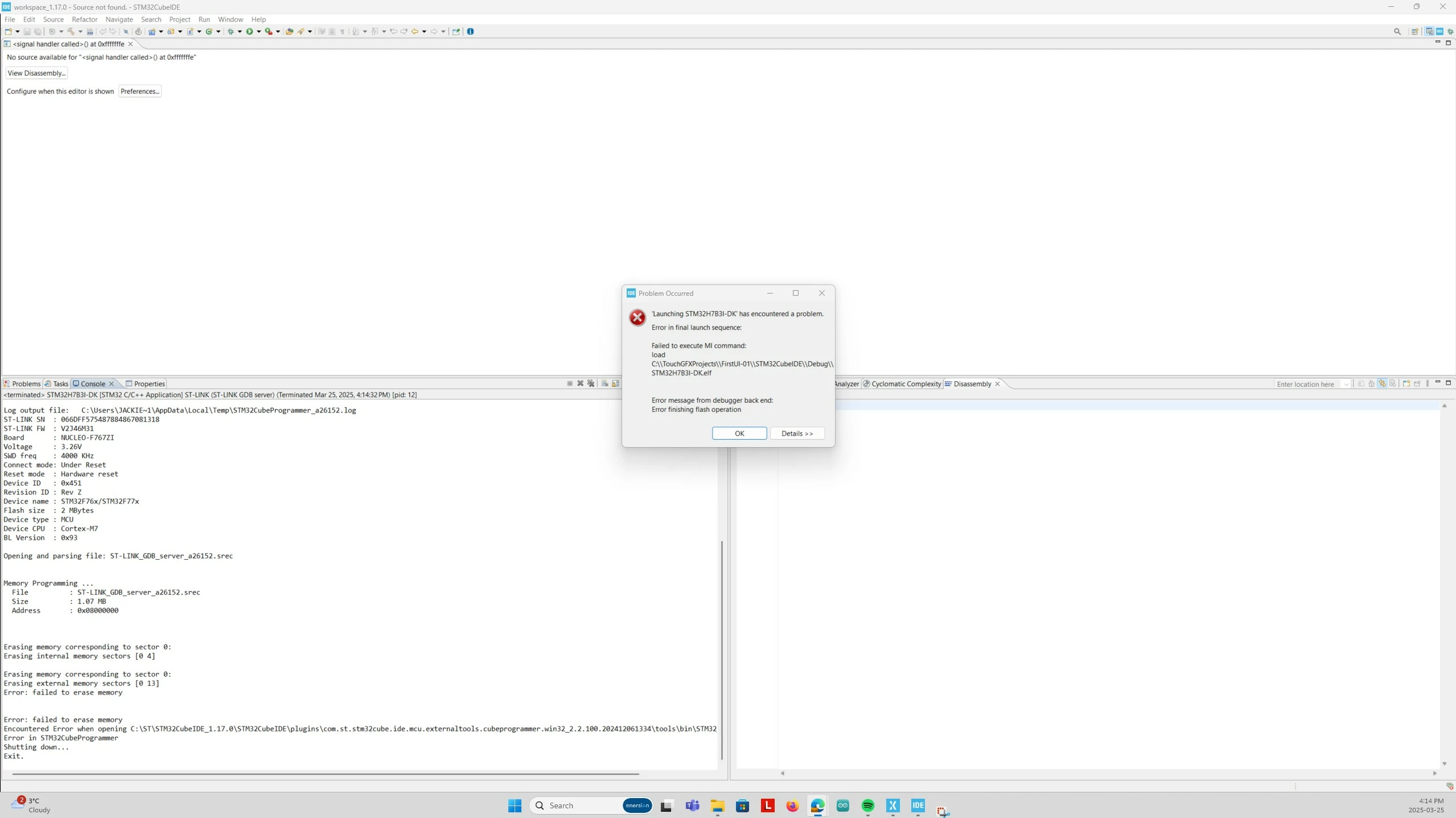

I created my first UI using the TouchGFX software but after when I opened the file in CubeIDE, Build the project and try to Debug it. I am getting this Issue
Iam New to STM32. Can someone help me?

    The video you show is only to create a GUI, it does not specify the hardware. To be able to flash, you need to know the hardware.
    If you are new, it would take a bit of time to create your own TouchGFX Board Setup (TBS) to tell the MCU how to behave to be able to control the display and memory and make your GUI work.
    So one solution could be to use a TBS that we have created.
    When opening TouchGFX Designer, you can click on "Create new" to see all the available TBS (you need to be connected to internet).
    I would recommend one of the new one such as The STM32U5G9-DK2, the STM32H7S78-DK or the STM32C071RB + RVA15MD display.
    If you want to create your own TBS, here is the documentation .
    If however, you did create a TBS, the error states that the flashing failed (could not finish flashing).
    Can you try to flash you board another way such as taking the executable and flashing it by using STM32CubeProgrammer?
