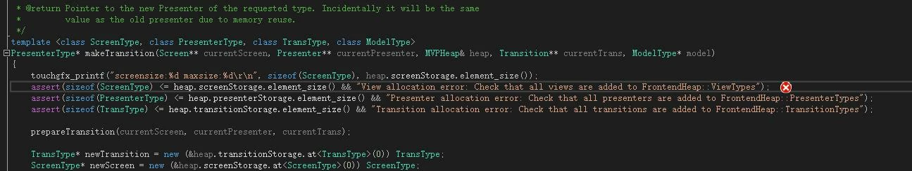

Dear support, Can I set default screen level storage size bigger?
  • July 5, 2021
  • 1630 views
Look over the debug message, my screen szie is oversize.
Can I set the default screen size bigger?
My screen widget is in a selfmake container, so that is hard to separate into different screens.

Best answer by Romain DIELEMAN
You can set the buffer size of a screen within TouchGFX Designer. To do so click on the screen's name in the tree view on the left, and then set the size within the screen's property on the right of TouchGFX Designer under "Canvas Buffer".
/Romain
/Romain

Thanks! it work.
