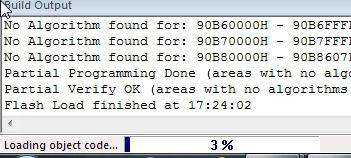

Than I edit project in TouchGFX editor, add one button, generate code, and build it in KEIL.
Than I download it to flash.
Then starting debug I get error, on this stage
this error

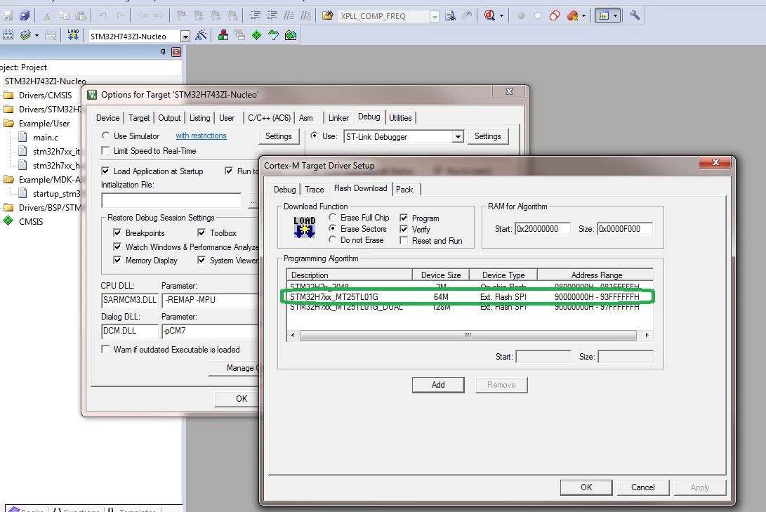

You need to select a Flash Algorithm for the external QSPI Flash

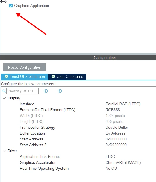

IT is TouchGFX problem.
If I set TouchGX off in CUbeMX - problem disappeared.

I havent downloaded you project (not really allowed to, shady link), could you give more info on how you configured TouchGFX in your project ? If you look at the application template available in TouchGFX Designer for the H747-eval, you can see in the folder /projectName/TouchGFX/target files that we have set ourselves. Those are not generated by TouchGFX Generator. There are more steps involved than just setting it in CubeMX.

Decide what end the problem is on, and focus on that. Your complaint seems to be it fails at the Download/Run end of the Keil tool chain. Perhaps focus on what's materially causing that failure. Who has a board this will load on to with QSPI? Not going to work on a stock Nucleo-H743ZI board.
Look at the .MAP, or the .AXF, this is where the smoking gun will be.
Turn off "Run to main()", and walk the code in.
Check if it tries to copy or access QSPI memory space during startup.
Check what TouchGFX is doing with it's assorted structures.
